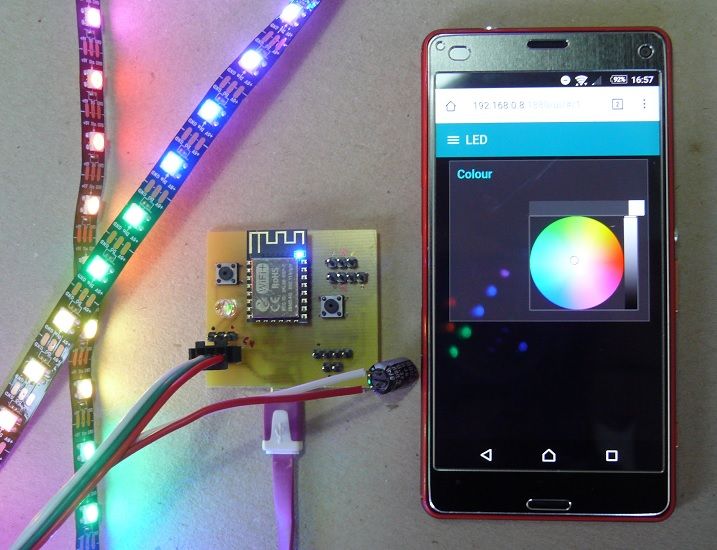

Step 5: NeoPixel Fun
Neopixels are great to play with. One can change every LED on a string of 60 to any of 16 million colours around 100 times a second (with the appropriate processor and code). The most popular Node-Red driver uses a Python library to implement the output and this is a little slower but also easier. Adafruit has a good guide and explanation of Neopixels if you want to delve deeper.
The plan is to drive several sections of the string independently from several colour pickers.
First create a new flow page for this work. Three lines icon>Flows>Add. Then rename it via Three lines icon>Flows>Rename and enter NeoPixel Fun and click ‘Done’.
To start add three nodes: a dashboard 'button', a function node and a Raspberry Pi 'rpi neopixels' node. Wire these together – button to function to neopixels. We will use these to setup a ‘clear’ string option.
Double click the button node so we can set it up. We want these controls in a new group on a new page(tab). Click the twidly at the end of the Group box and select ‘Add new ui_group’. Click the pencil icon to set this. Enter Controls into the Name box. Then click the twidly at the end of the Tab box and select ‘Add new ui_tab’. Click the pencil icon to set this. Enter Neopixel Fun into the Name box. Click Add, then Add again. Now set the size to 2x1. Lastly enter ‘Clear’ into the Label box and click ‘Done’.
Double click the function node, enter ‘Clear’ in the Name box and add the code
msg.payload = "#000000";
to line 1 of the function code. This is the colour RGB 0,0,0 that turns all off.
Click ‘Done’.
Double click the rpi neopixel node. Enter the number of pixels in the string – 60 in my case. Then enter 0,0,0 into both the Background and Foreground boxes. This turns these off. Click Done.
This is a good point to connect up the neopixel string. First power it up, then connect the ground to a ground pin on the Pi (e.g. pin 14) and then the data lead (via the 330ohm resistor) to pin 12.
Now click Deploy. The string should come to life showing red, green and blue followed by all off.
Now add a dashboard 'colour picker' and a function node. Wire 'colour picker' to function node to 'rpi neopixel' node.
Double Click the colour picker. Click the twidly to change the group to [NeoPixel Fun] Controls. Set the size to 4x4, enter 1 in the label box, set the format to ‘rgb’, untick the 'Show lightness slider', tick 'Always show picker', and set Payload to ‘current value as an object’. This latter setting makes it much easier to select the individual r, g and b values that we need to do in the function to convert the data into the format required by the rpi neopixel node. Click ‘Done’.
The data format required to set pixels x to y to the colour rgb is a string “x,y,r,g,b”. In this case we are going to set pixels 1 to 4 to the rgb from the colour picker. Double click the function node. Enter 1 to 4 as the Name and in the function code line 1 enter:
msg.payload = "1,4,"+msg.payload.r +","+msg.payload.g+","+msg.payload.b;
and then click 'Done'.
We need to do a bit of tweeking to the user interface. Click the dashboard tab (chart icon) in the right hand pane. On the Layout tab click and drag the 'NeoPixel Fun' above the 'Switch Fun'. This puts 'NeoPixel Fun' as the top page. Expand 'Controls', drag 'Clear' above '1' if necessary. Then, while hovering over 'Controls', click '+ spacer' and drag the spacer above 'Clear'. This moves the button away from the left edge.
Click ‘Deploy’ and open the Node-Red user interface page.
Now have a play changing the colour of the pixels 1-4.
We now need some more colour pickers to direct some more LEDs. Fortunately Node-Red supports copy and paste.
Click and drag over the colour picker and its associated function node. Enter ctrl+C to copy and ctrl+V to paste. Do the latter 3 times to create 3 more pairs of colour picker and function nodes.
Next edit each of the new colour pickers to give labels of 2,3,4 respectively. Then edit the function node associated with colour picker 2. Change the label to 6 to 9 and in line 1 of the code change 1,4, to 6,9, and click ‘Done’. Repeat this for the other two function nodes with labels 11 to 14 and 16 to 19 and changing the line 1 code 1,4, to 11,14, and 16,19, respectively. Add wires from each of the three new function nodes to the ‘rpi neopixel' node.
If there is more than one smartphone one can allocate each to one colour picker and they can all control their ‘own’ pixels independently at the same time.

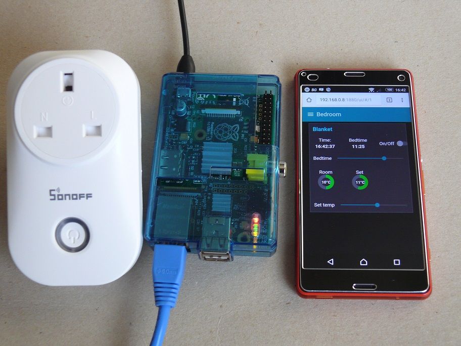

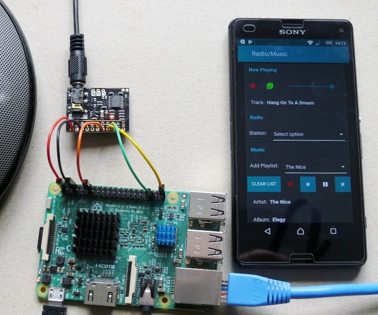

![]() | Powerful Standalone Home Automation System - Pi, Node-Red |
![]() | Home Automation Sonoff-Tasmota Sensors, LEDs, Neopixels |

Drive a Pi based music system (MPD) and create an MP3 player/internet radio. See:
![]() | HQ Music Player and Internet Radio With Smartphone Control |
Send commands to run other programs on the Pi.
