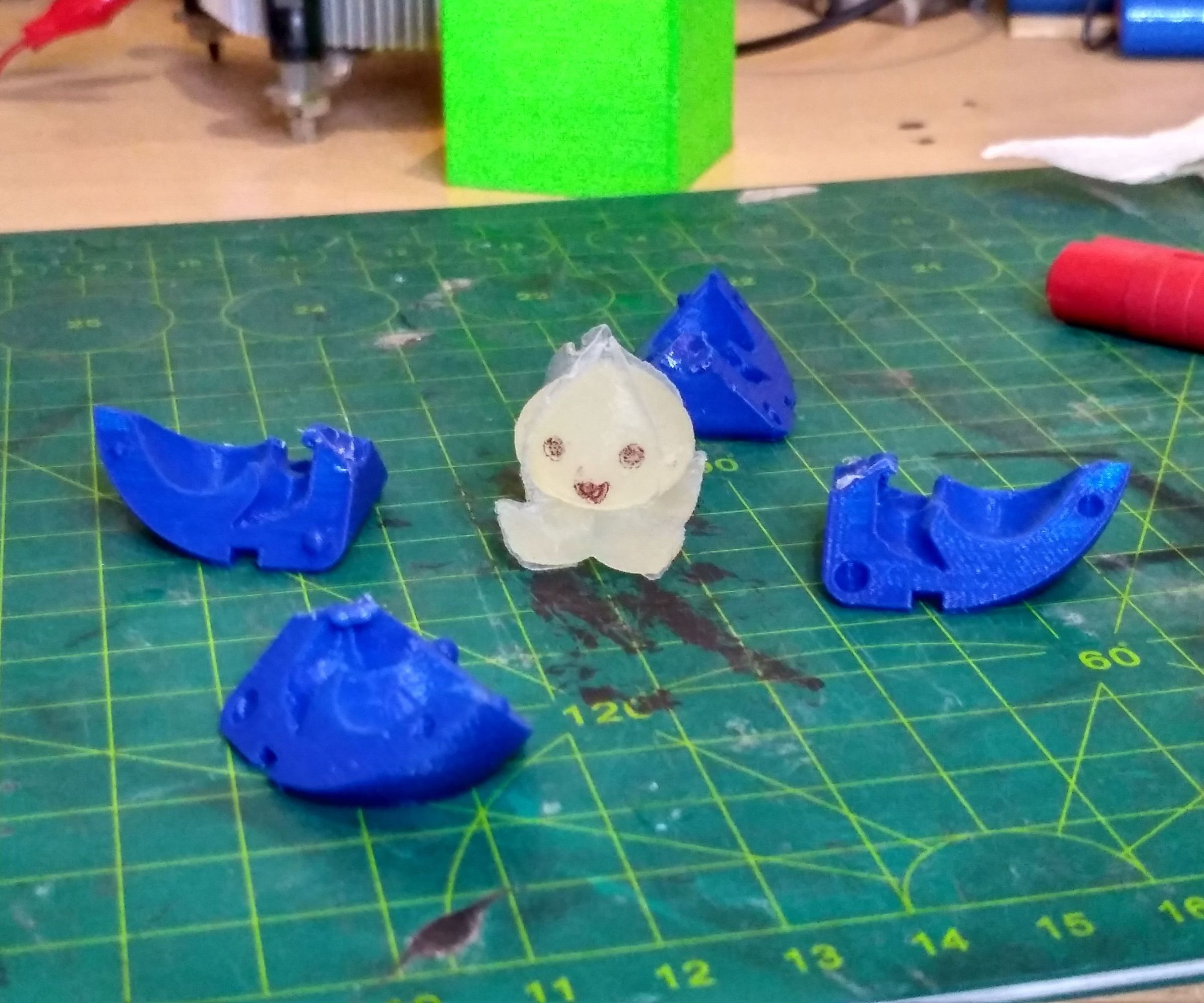

If you have access to a 3D printer, you can also print out the watch to check its dimensions and feel in your hands, and if the other watch parts are suitable for it. I’d advise against testing fit or tolerance though, as FDM parts will differ significantly from a milled part in terms of tolerances & accuracy.

Step 24: The Postmortem
So originally I was going to include double sided milling here, but I ran into an important lesson instead. That lesson took the shape of ramming the endmill diagonally through the stock, leaving it look like a lunar probe crash landed on the surface of the Moon. Remember when I said WCS was important? Turns out that I hadn't taken that to heart myself. This was the second crash I had, the first time everything looked good but I had the WCS setup exactly backwards so it started drilling the alignment hole, then charged off into the opposite direction of the part and hit the endstops.
The point I'm trying to make is that even though I spent hours optimizing every last process, sometimes you still miss out on things. Often the only way to learn is to persevere through these happy little accidents, and improve on them next time. I think this is a good time to end this particular exploration/guide, next time I'll cover aluminum milling and 2 sided milling.
