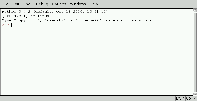

Open Python 3 (IDLE) from Menu > Programming. The window you see is called the Python interpreter or shell window. The three greater-than characters ">>>" are called the prompt. When you see the prompt that means Python is waiting for you to tell it to do something. Let's give it some code!

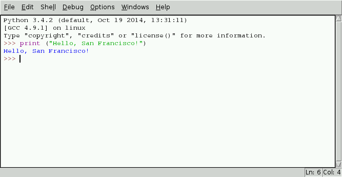

Type the following statement to give a shout out to the city you live in. I live in San Francisco so my statement be:
print("Hello, San Francisco!")
Hit enter and whatever you put in between the quotes will print in the shell under the prompt. The print() statement differs between Python 2 and Python 3. In Python 2 parenthesis are not used and looks like this:
print "Hello, San Francisco!"
You have just performed the basic "hello, world" of Python but with a small (super small) twist. Let's stop here and identify what it is you just typed.

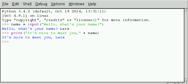

Let's make the interaction between you and Python more dynamic by adding user input. In a new window, type the following:
name = input("Hello, what's your name? ")
The input() function takes user input from the keyboard and gives you the option of prompting the user with a message. In this case, that message is a greeting and question asking the user (you) what your name is. After hitting enter, the question will print and wait for your response. Go ahead and answer with your name.
The name = to the left of the input() function is called a variable.
Variables
Like functions, variables are also a core element of any programming language. A variable acts like an empty container that you can put a piece of data in. When you drop data in, you give it a name as if you are writing it on the outside of the container. The unique name you give it can then be used to reference the data inside throughout your program. You can name a variable almost anything, but it should be as descriptive as possible. This makes your program easier to understand when you read it later. Data stored inside a variable can change; you will see an example of this in the next lesson.
Your name was stored in the variable called name (try calling it something else). You can now use the name variable in the print() function and add it to a message using the "+" character:
print("It's nice to meet you, " + name)

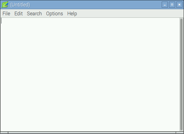

Unlike the shell, an editor is used so you can save and edit your Python programs. Although there are several editors you can use, IDLE comes with one so let's start with that.
Create a new file in IDLE by pressing Ctrl + N or navigate to File > New.
Notice how the window you see doesn't have the ">>>" prompt. You are now in the editor and ready to write, save, and run a Python program. Write out the program you created in the shell including the two new lines you came up with in the last section. As an example, here is my final script:

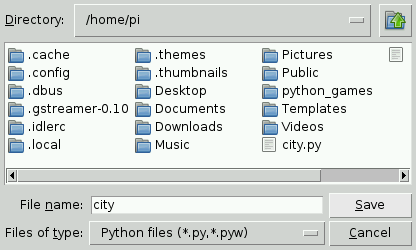

Save it as city.py. The default location is your home directory.

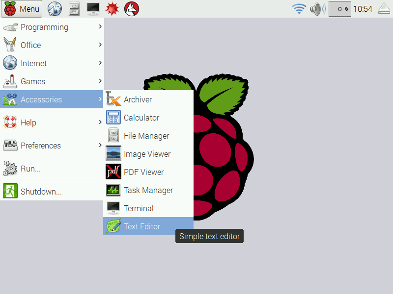

IDLE is a great way to start writing Python programs but you do not have to use it. You can create a Python program using any text editor as long as it's saved with .py at the end. IDLE is one example of a desktop graphical text editor. Another one that comes bundled with Raspbian is called Leafpad. You can find Leafpad under Accessories in the start Menu.
