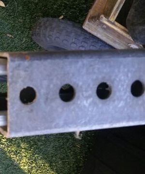

Step 2: Step 2: Collecting Stuff for Parts.
The work bench always has boxes and buckets of assorted salvaged items that seem valuable, stored beneath, beside, over, on the wall on shelves, basically too much stuff, but it always gets recycled to something.
- The adjustable slide is made of a car seat slide.
- The hack saw blade is a registration device to regulate the teeth being reground into the old blade.
- The altered strap hing has a sharpened, bent, edge that holds against the hack saw teeth.
- A 2" hole saw waste circle is used in two places as adjustable stops. The wing nut at left one, and tall handle on right one, loosen and allow circle to rotate eccentrically on a hole drilled between axis and outer edge. Sand paper had to be glued to the bottom of both eccentrics to prevent movement.
- Just about any old Dremmel type tool can be used to run the sharpening wheel. Drill holes for hose clamp to pass through base. Do not make hose clamp very tight to avoid distorting motor coils.
- The 3/4" plywood of the base is a special sign board type with an impregnated paper coating, very water resistant..
