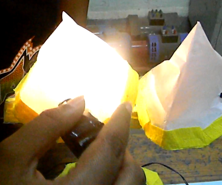

Step 2: The Work in Progress :
The IoT enabled smart aquarium is in its prototyping stage:
