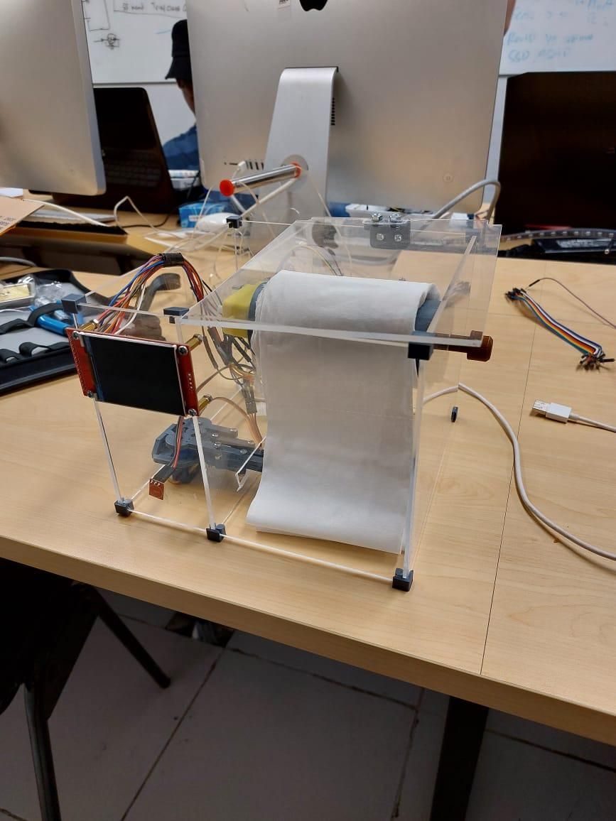

Step 2: Assemble the Hardware
Assemble the Hardware as shown in the picture above.
Assemble the base frame for the project using the 1/2" PVC Pipes into a block shape and use the pipe PVC elbow connectors. Attach the tube to the 3D printed linear slide part and glue the edge with glue gun

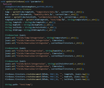

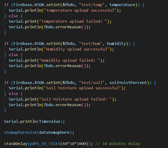

This is the main code that we use to develop our IoT project. In this code that we have provided, it is the latest version. the libraries are all included in the platform.ini. We coded our program using Semaphore RTOS since there will be some programs that will be executed at the same time.
Our void setup is used to setup some initial values from the GPIO pin such as the MOSFET pin, Stepper motor, the limit switches and also setup for the OLED display to be able to display. We also locate the wifisetup() void in the void setup so that the ESP32 understands that it needs to connect to the Wi-Fi as it begins to initiate the program. In the void setup we also give out each void the function for its own semaphore task and give stack sizes for each void. After that we configured the void wifiSetup that we use to connect to WiFi. in this case we are using the WiFi manager (Libraries will be included in the platform.ini)
Afterwards the ESP2 will try to connect and authenticate to the Firebase that its connected to. The ESP32 will then fetch from the firebase. In this case it will be in the form of JSON data as we have a feature of user able to set alarm for when to water the plant and thus it fetches the initial information for the Boolean value of each day from Monday to Sunday.
Once it is connected, the ESP32 will configure the NTP and gets the time directly from the NTP server with small configuration from our program to change it into Indonesia current time as per Waktu Indonesia Barat.
Then it will read the humidity from the DHT11 sensor and also the soilmoisture sensor. After that it will update the data that the sensor has fetched from the previous void and updates it to the firebase. Both for the RTDB and the Firestore. We use the RTDB to fetch the data in real time as the sensor detect changes from the surrounding environment. As for the Firestore, we configure it so that it's able to store the data historically.

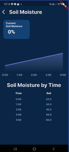

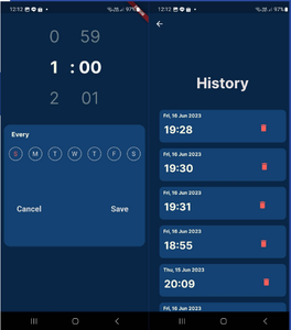

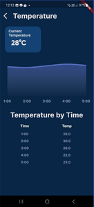

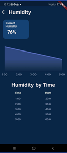

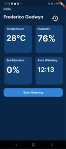

Here we have the mobile application developed by using flutter. The code will be represented in the Github link below for reference. In the mobile application, we have the homepage view of mobile Apps showing RTDB Temperature, Humidity and Soil Moisture data. We also designed a Button that functions to send boolean data to firebase. If the boolean value is true then the system will start to run and water the plant.
The temperature page, Humidity page and soil moisture sensor page all shows RTDB temperature data, chart and history of temperatures
And lastly there's a page that shows the time to water the plants automatically and the data is saved to firebase.

In this step we would setup the Firebase for the RTDB and the Firestore. We configured the RTDB to fetch the real time data from the sensor that it fetches and the Firestore is used to store historical data.
