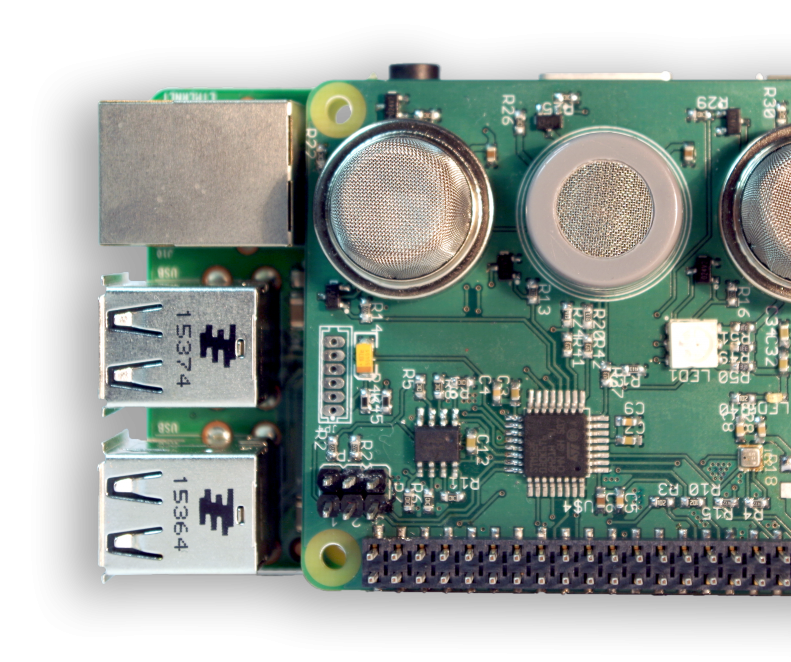

Introduction: IoT Bit Functions
About: Altitude Tech LTD is founded by professionals and students in the area of robotics, electronics and product design, which makes the team the heart of the company.
In this instructable, we will show you how to use the IoT Bit Functions GUI for your minicomputers like the Raspberry Pi 1,2 and 3. The functions the GUI will have in V1 are:
  • "Send SMS",
  • "Display SMS",
  • "Delete SMS",
  • "Make Call",
  • "Hang up",
  • "Set GPIO to HIGH/LOW"
  • "Signal Quality"
These functions simplify communicating with the IoT Bit modem and by using them in an automated script we'll be able to control hardware attached to the Raspberry Pi's GPIO pins by simply sending an SMS to the IoT Bit. This can be useful in many projects, where you want to turn on or off the devices from a remote location, it can be done with nearly any device if properly set up.
In this Instructable we will show the very first version of the IoT Bit graphical user interface and how to set up a python script to have the "Set GPIO High/Low " function always running so if an SMS is sent it will automatically, set the chosen pin.
