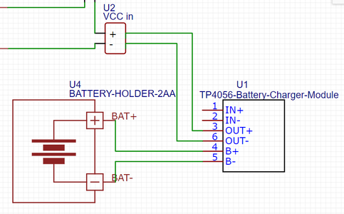

Starting from the battery circuit, we parallel the two battery case holders by connecting the same VCC to B+ and the same ground to B- so that the voltage that comes out of the battery remains 3.7v and the battery capacity becomes larger.
P.S. The battery circuit and the esp32-cam circuit are made separately on the PCB. Also, the picture above is just an illustration of how to connect the battery to the charger module and the output to the PCB.

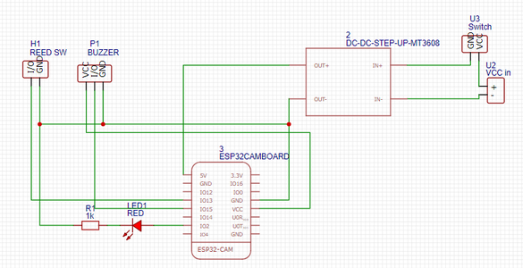

Step 2: Design the ESP32-CAM Circuit
Connect the line from terminal block U2 which is the VCC input from the output + Battery charger module to terminal block U3 which is a switch as a connector and breaker of electricity from the battery and connects ground fellow. Then, connect to the input + step-up module as a voltage amplifier from 3.7v to 5v and connect the line from the output + step-up to 5v on the ESP32-CAM and connect the same ground. Next, connect the VCC output on the esp32-cam to VCC on the buzzer, ground to ground, and I/O buzzer to IO15 on the esp. Next, because the magnetic sensor has no polarity, one of the pins connects to IO13 and one of them goes to the ground. Finally, connect IO2 to the anode on the LED, and the cathode is connected to a 1k resistor then connect it to the ground.

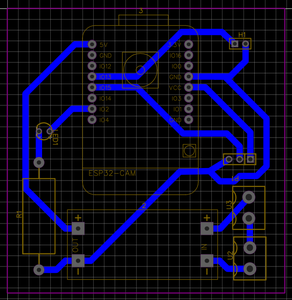

Step 3: Convert the Circuit Into PCB
We just convert the esp32-cam circuit to PCB and the battery circuit will be made with Double Layer Trough Hole PCB. To convert the circuit that we made previously into PCB, we use EasyEDA software to convert it. Then, make the size of the PCB around 7x7cm. Arrange all the components efficiently and set the PCB track width to 1.5 mm as the PCB track will be the bottom layer. You can route by yourself or auto-routing the components from the software. To prevent short circuits (VCC line colliding with the ground), ensure that the PCB lines are spaced widely apart. Lastly, adjust the options when exporting to PDF in accordance with the example shown above.
Here's an example of the esp32-cam PCB circuit below:

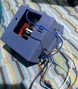

Step 8: Create 3D Printing Case
For the PCB case, we use fusion360, and here's our case file:
Step 9: Finishing the Briefcase
For the finishing, we Insert the esp32-cam PCB into a 3D printing case. After that, connect the cable to the terminal block. We also made holes in the base cover of the briefcase to place the 3D printing case and the side of the briefcase base cover to attach the magnetic sensor. Then we also made holes in the side of the briefcase for the charger hole. Then we attached the battery PCB using hot glue, then attached the battery case holder and 3d printing using double-sided tape. Don't forget to attach the magnet to the side of the briefcase cover and adjust its location with the magnetic sensor. Here you go, the briefcase is done.

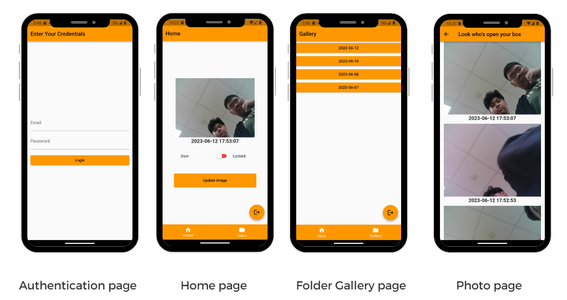

Step 10: Create App
To create our app, we use Flutter in Visual Studio Code, and here's our link code:
https://github.com/JasonJason1/SATLINEMADE.git
