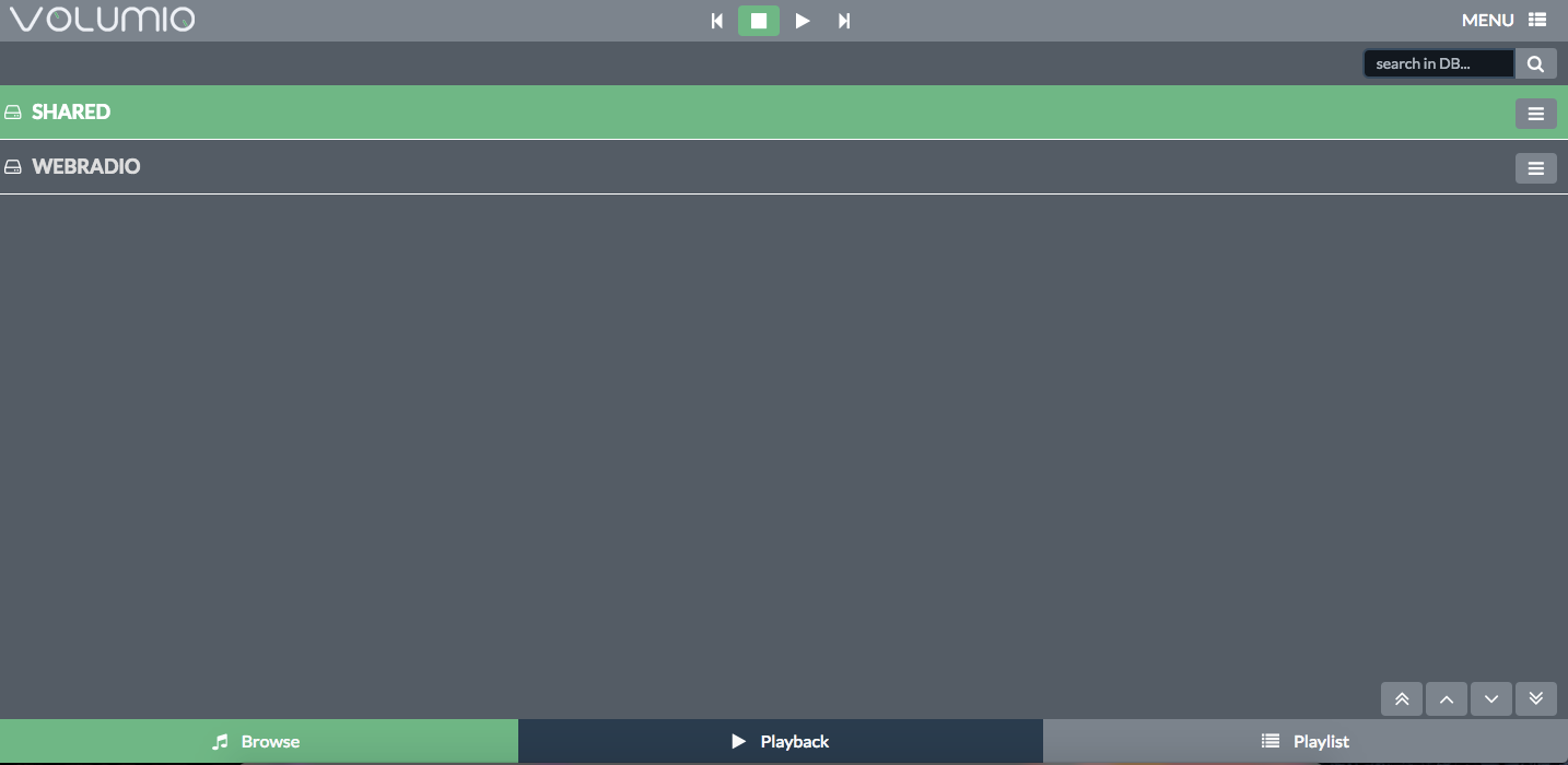

Step 3: CONNECT YOUR SPEAKER AND SET VOLUMIO
Volumio is the app that manages your music and let you automate your speaker.
- Connect your Raspberry Pi and speaker via auxiliary cable
- Put the music you want on your USB plug and plug it to your Raspberry Pi’s USB plug.

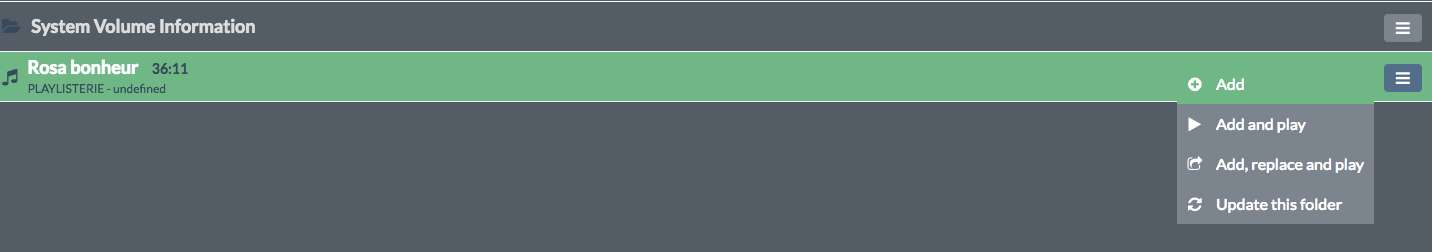

Now it’s time to set the Volumio app.
- Go to App Libraries and download Volumio app
- Open Volumio
- Click on the bottom left button “Browse”
- There you will be able to select the songs and radio stations you want to play and/or add to a playlist
The shared folder contains the audio files added on your USB stick.

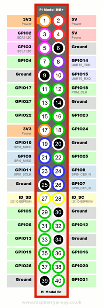

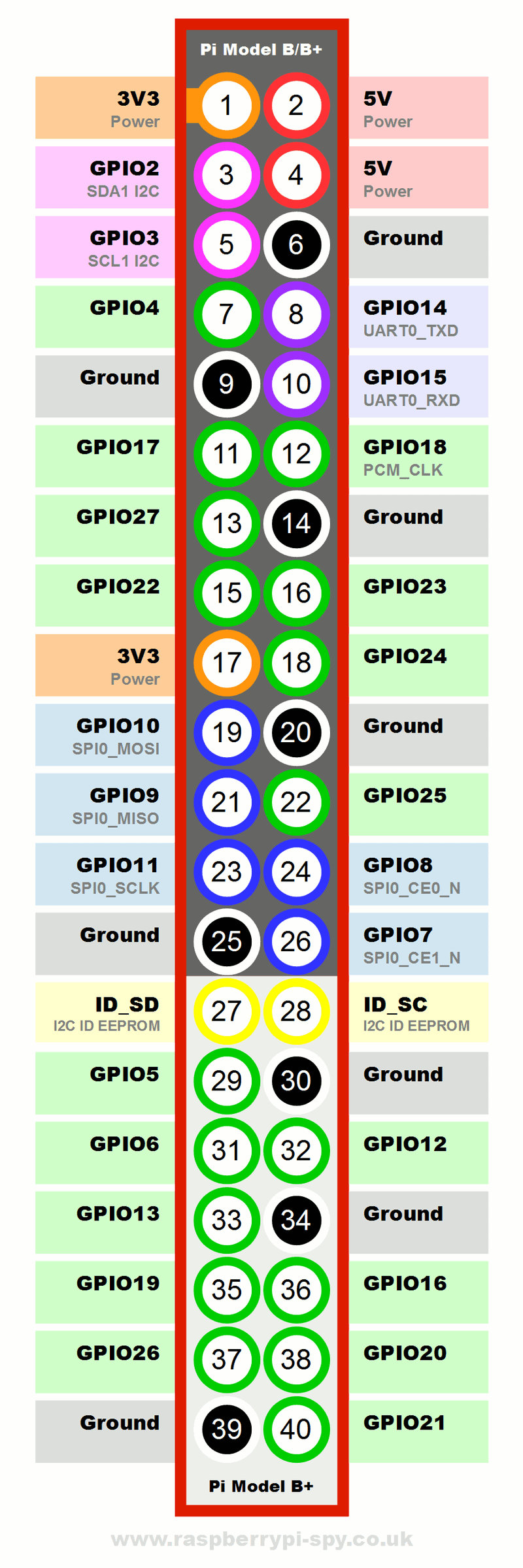

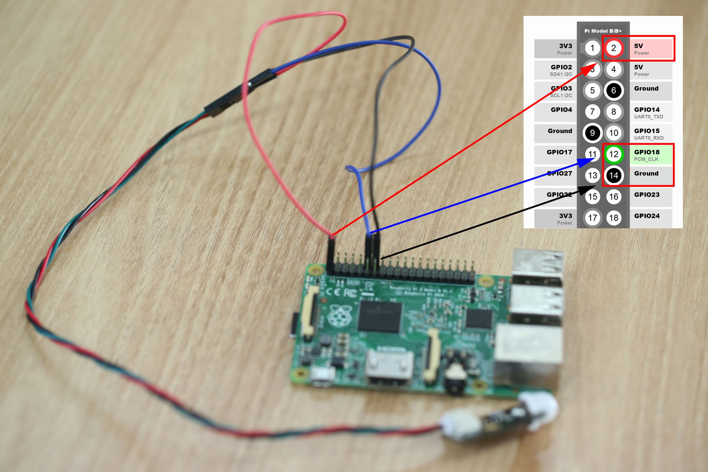

Step 4: SET UP YOUR PIR SENSOR
As you can see, next to your sensor’s pins are small indications on what each pin is made for:
- D is for Data
- + is for the current connection
- - is for the ground connection
Simply connect as in the picture below to set properly.
For the quick explanation, the RED cable is connected to a 5V pin (PIN02), the BLACK cable is connected to a ground pin (PIN 14) and the BLUE cable is connected to GPIO18 (PIN 12).
You can look at the map below if you need any direction.

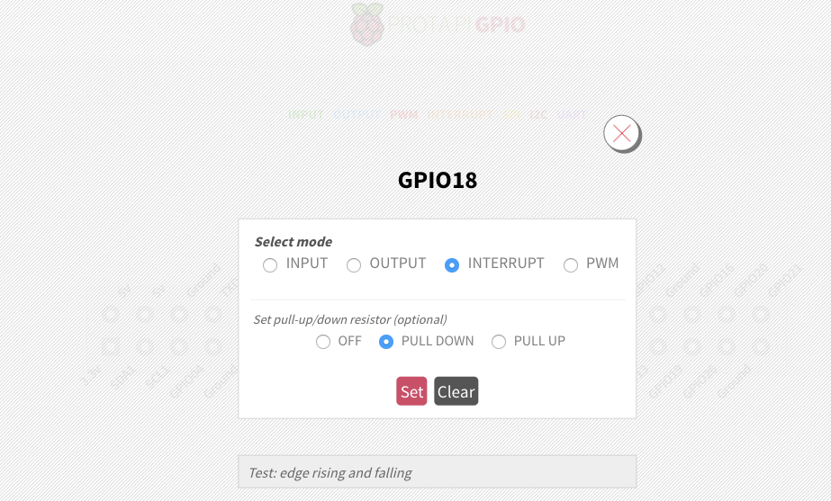

- Now let’s open Prota Space.
- If you haven’t done it yet, download the GPIO app in App Libraries.
- In GPIO app, click on GPIO18. Select “Interrupt” and “Pull down”. Click on “set”.
The sensor is now set up.
Move your hand around, you should see notifications of “rising interrupt” on the GPIO app page.

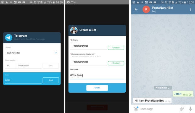

Step 5: SET UP YOUR TELEGRAM BOT
A Telegram bot is a virtual assistant that you can create on Telegram messenger app.
If you want to learn more about Telegram bots, don’t hesitate to read this previous Instructables.
- Download Telegram app on your smartphone and create an account
- Download Telegram app on your Prota Pi (in App Libraries)
- Open the Telegram app on Prota and click on “Request Authorization”
- Set a name and username for your bot, then click on "Create"
Your bot is now created! Once the automation is setup (next step), the bot will react to the message you send it to reduce, increase the volume or stop the music.

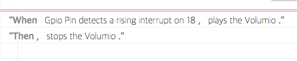

We will now write the four following automation storylines
- When a motion is detected, the playlist starts and play for 3 minutes until there are no more motion detected.
- When you send “Up” to TelegramBot, speaker’s music increases
- When you send “Down” to TelegramBot, speaker’s music decreases
- When you send “Stop” to TelegramBot, speaker’s music stops
Speaker automation
- Go to Stories app
- Click on + and then on “When”
- Select GPIO as the sensor of your story and set it to “when GPIO detects is a rising interrupt on GPIO18”. This means when a motion is detected.
- Select Volumio as the actor of your story and set the action to “play the Volumio”. This will play the playlist you previously prepared.
- Click on “Extra options: Delay” and set the delay to 5 minutes. This sets the timelapse the music should keep playing until there is no more motion detected.
- Click on “then” to add a follow-up actor-story. Select Volumio as actor and “stop the volumio” as action.
- Click on the save icon.

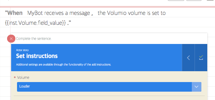

TelegramBot
- Select TelegramBot as Sensor. Select “receive a message” as event and add the condition “text equal to - Up”.
- Select Volumio as actor and set the action to “set the volume to - louder”
- Save.
- Click on + again and set a similar storyline with “Down” as message and “Quiet” as volume setting.
- Click on + again and set a similar storyline with “Stop” as message and with “stops the volumio” as action.
