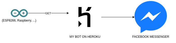

Step 2: Facebook Messenger
How does the Messenger Platform work?
When a person texts your business on Messenger, their message is sent to the Facebook server. The Facebook server then sends webhooks to your business server, where your Messenger App is hosted. Using the Send API, your app can respond to the person on Messenger. In this way, you can construct guided conversations to lead people through an automated flow or build an app to serve as a bridge between your agents and your business presence on Messenger. The Messenger Platform does not require any payment to use. It is meant for businesses to handle inquiries from their customers. Once you build your experience for your customers to interact with, you can then leverage Click-to-Messenger Ads to bring people to your experience.
My Project
Connect with me
- Open my bot at: https://m.me/KenhTayMay
- Chat "Hello" to retrieve an automatic message
Click the push button in the automatic message
Another message tells you a random string. Save the string to use for the next step

Step 4: Bonus
This is a simple example of how to use esp8266 messaging to facebook messenger.
In addition to telling the rain, you can customize my bot to announce many other things as I am using it in my smart home system.
