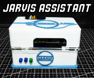

Step 7: The Case
The case is 3D printable, created by me on onshape and it can be found on my printable profile.
How to build:
  1. Place the Base.stl with 4 screws on the corners.
  2. Fasten the 22.00 mm brass standoffs onto the screws.
  3. Put the EletronicsBox.stl on top of the base with the four corners aligned.
  4. You can now place all the LEDs into the holes on the box, and build the circuit.
  5. Now put the BaseOrangePI.stl on top of everything and fasten the 5.00mm standoffs.
  6. Put the Orange Pi 3lts and top it all with the OrangePIBox.stl
