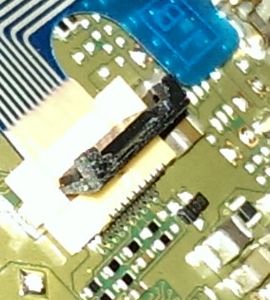

Step 5: Removing the HDD and Tray
The HDD itself isn't screwed down. It's held in place with rubber cushions. Be careful with the ribbon cable, it should be removed from the circuit board side, not the HDD side. You can flip the latch holding the cable in place with your fingernail, or a small spudger.

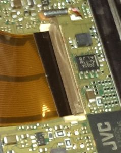

Step 6: One More Ribbon Cable
This one goes to the zoom and shutter controls...
