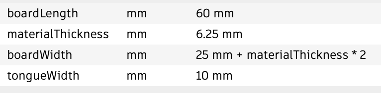

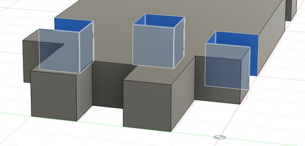

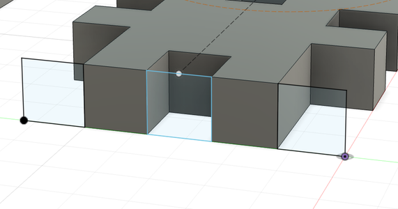

Make some parameters in Fusion. The width of the component needs to be 5 times the material thickness. Start with an extruded rectangle and cut material thickness size notches in the end, side and middle as shown. Each of the notches are material thickness in width. Notice there are two unit of cutout on the sides and that the middle cut is four units in from the end.

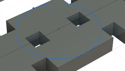

Use lines from the midpoints of the edges to find the midpoint of the component. Use this midpoint for the center of a circle. Make a circular pattern with the circle as the axis. Set the number to 2 and the pattern will duplicate to the other side. This step is only necessary if you want to keep expanding your joint with more pieces. A single joint only needs one end to be notched.

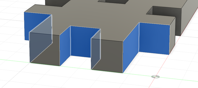

This shape was a copy of the first with some additional cuts as shown
