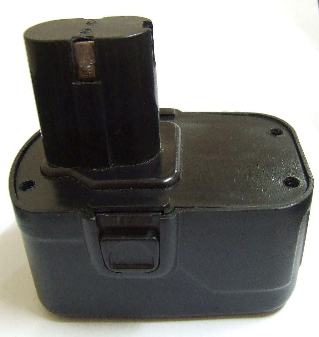

Start by removing the screws that holds the battery pack together and remove the cover.

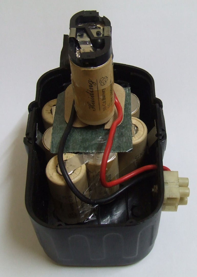

Find a suitable place for a connector and cut or drill a hole to suit the connector.
Solder a wire to the Positive and Negative of the battery Pack then ,run these wires to the connector.
screw the cover back on and connect the Jumper Leads. You now have a 12 Volt portable Power Pack,
