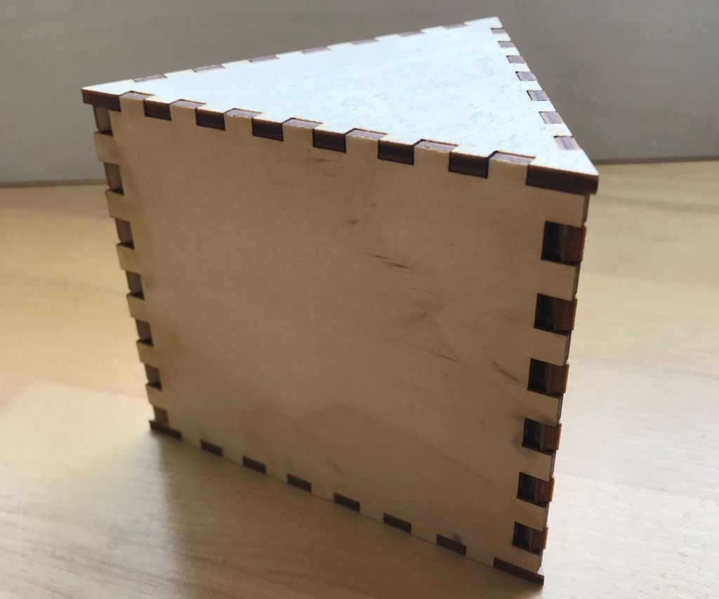

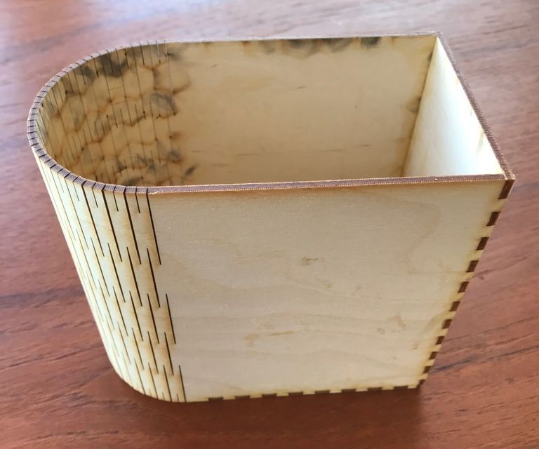

This instructable shows how to calculate kerf when making a box. Kerf is the width of material removed in the cutting process. Compensating for kerf will insure that your joints have just the right snug-ness.
We use the free MakerCase box generator, but knowing how to calculate kerf will help with any multi-piece project.

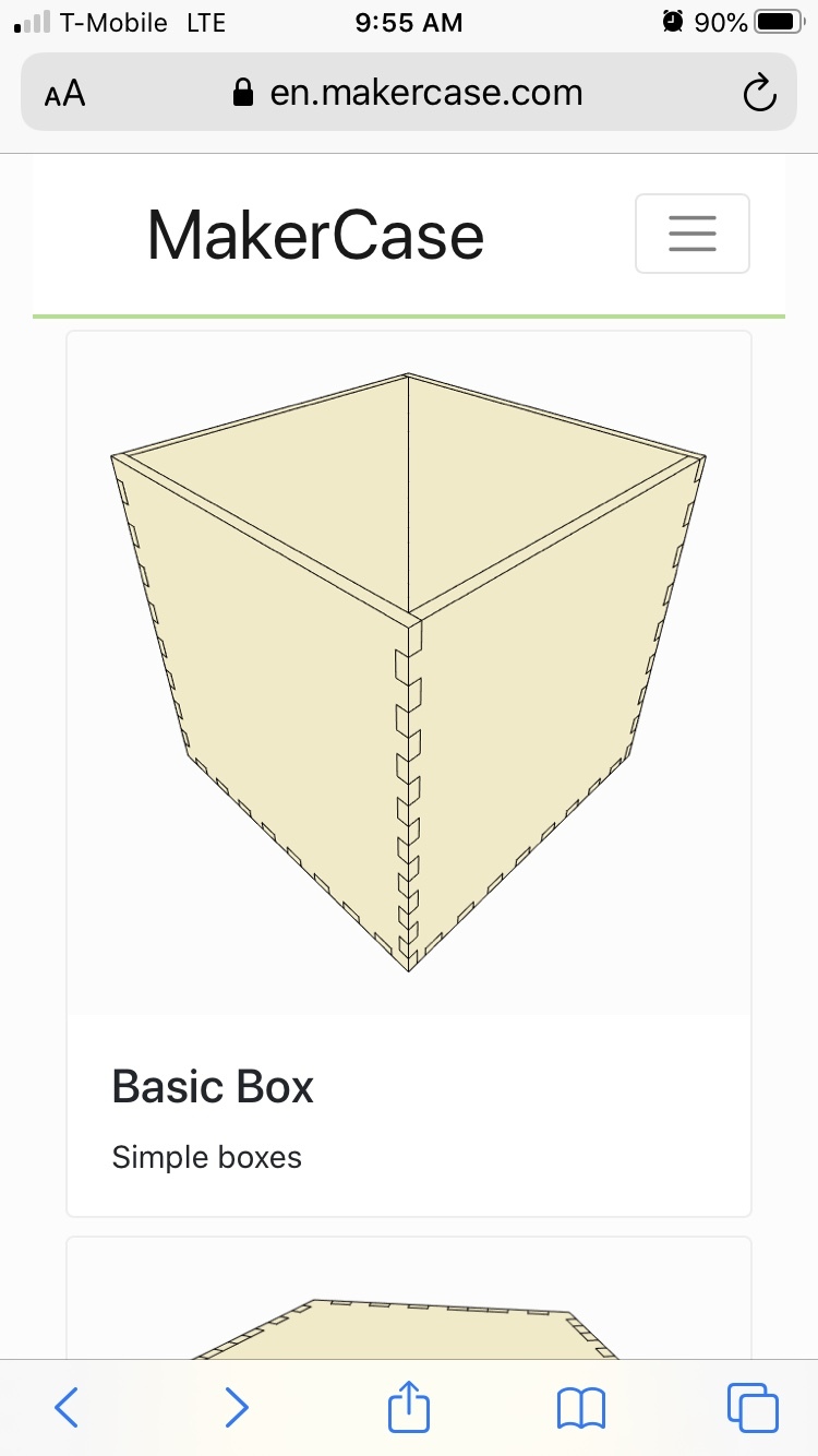

Step 4: Set Box Dimensions and Kerf in MakerCase
In step 3, we calculated kerf to be 0.005. This value represents the full width of the laser beam. However, the laser beam travels along the center of the cut line, so only half of the laser beam falls inside the part. Therefore, you only need to offset each cut line by one half the laser beam's kerf value.
Go to Makercase.com and choose the basic box generator. Enter desired dimensions. Then, click the green "download box plans" button. A window pops up with plans. Select the "Kerf and Corner Compensation" tab.
To determine the kerf compensation value in MakerCase, divide the kerf value by 2.
In our example, this is: 0.005/2 = 0.0025. Enter this value (0.0025) in the kerf field.
Click either the SVG or DXF button, depending on which format you'd like your plans.
