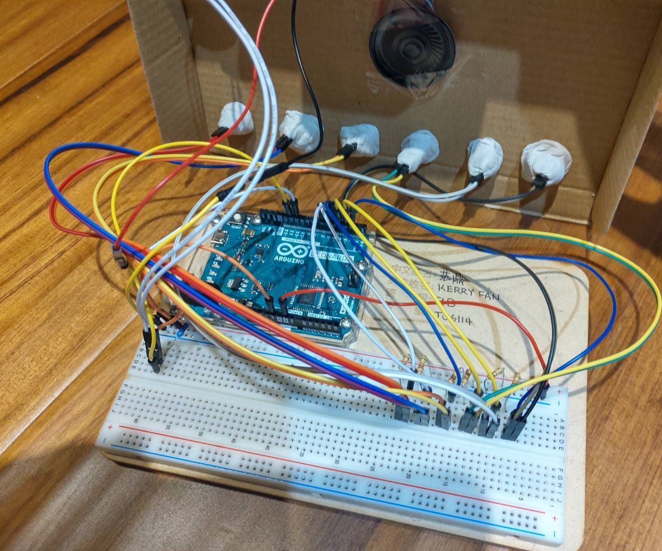

Step 1: Step 1: Assemble Ultrasonic Sensor
First, stick two wires from the positive and negative electrode on the breadboard to 5V and GND. Get the ultrasonic sensor and the breadboard. Stick the ultrasonic sensor on the bottom row of the breadboard, and stick four wires from VCC to the positive electrode on the breadboard; Trig to D5; Echo to D4; GND to the negative electrode on the breadboard.
Step 2: Step 2: Assemble Speaker
Second, stick the black wire(negative) of the speaker on the negative electrode on the breadboard, and stick the red wire(positive) on D7.
Step 3: Step 3: Assemble Liquid-Crystal Display
At last, get the LCD(Liquid-Crystal Display) and four Male-female plug connecting wires. Stick the wire from GND to the negative electrode on the breadboard; VCC to the positive electrode on the breadboard; SDA to the SDA on the Ardunio board; SCL to the SCL on the Ardunio board (Incorrect connection of the positive and negative poles will cause the Arduino to burn).

Get a carton, at least 20cm x 15cm x 10cm (the bigger the carton is, the more convenient you have to put the project in it). Cut a hole using the utility knife on the front of the box, the hole should be 5 x 2.5 so that the ultrasonic sensor can work successfully. Cut another hole with 7.5 x 2.5 cm. Put the LCD display in the hole and use the tape to fix it. Same as the ultrasonic sensor.
