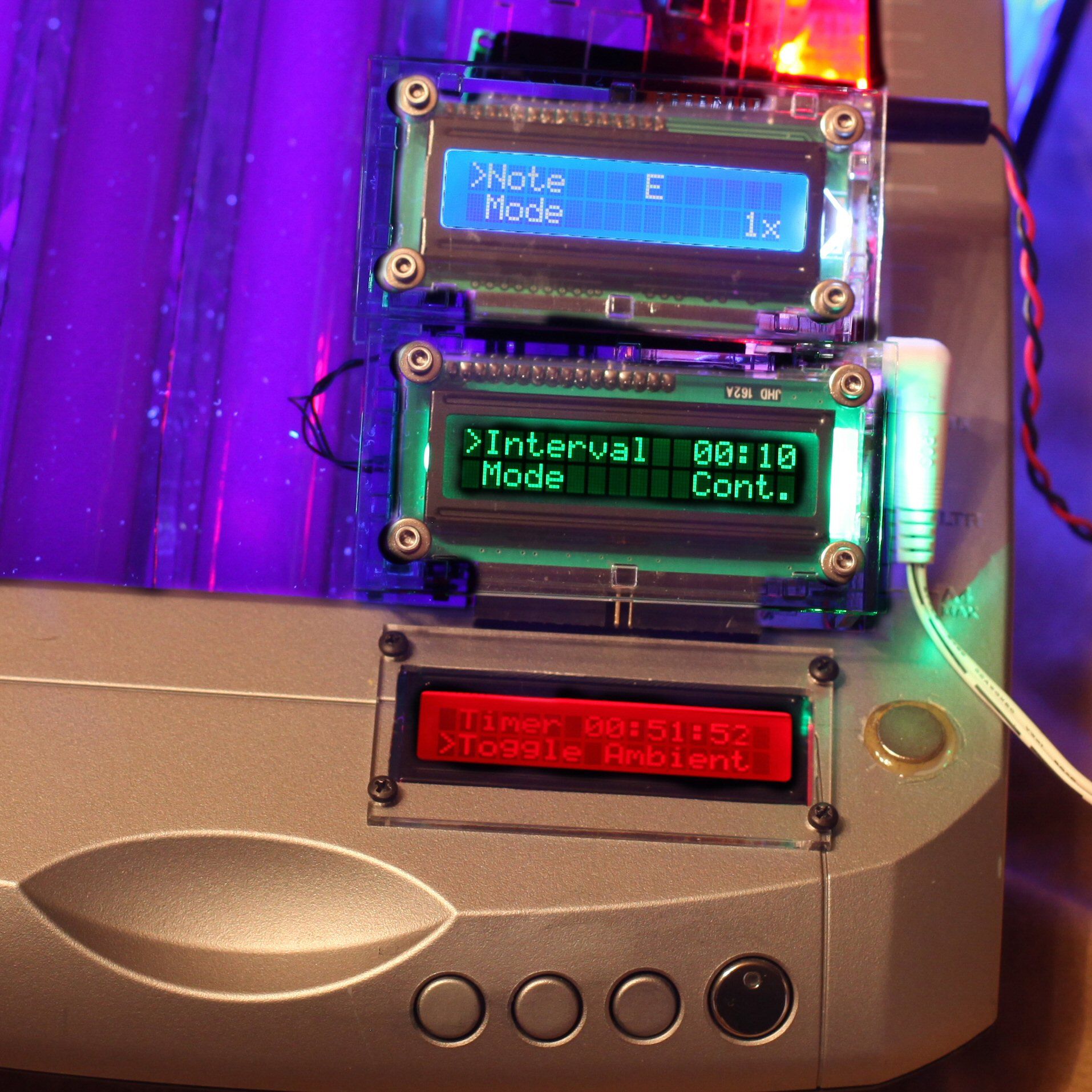

Introduction: Killer PCBs
This instructable demonstrates the process for making printed circuit boards with features as small as 0.005suitable for LQFP or QFN ICs using negative dry film photoresist. This will enable you to handle just about any kind of integrated circuit available--even ball grid array! Pictured are boards with a TSSOP-14, QFN-40 packages using a .65mm pitch and zero insertion force flex sockets with .5mm pitch.
