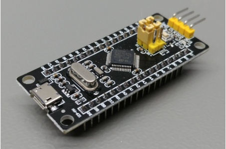

  1. STM 32 BOARD
  2. USB TYPE C CABLE

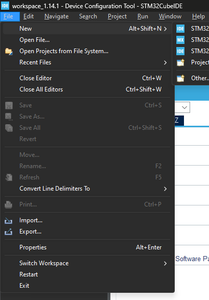

As we head into programming in the CUBE IDE head over to the top left and create a new STM32 project by clicking on "FILE" and then "NEW" then after on new "STM32 Project"

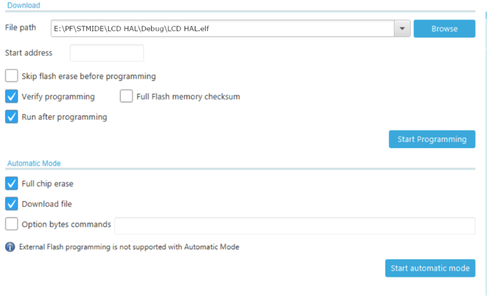

Step 6: Using the Binary File

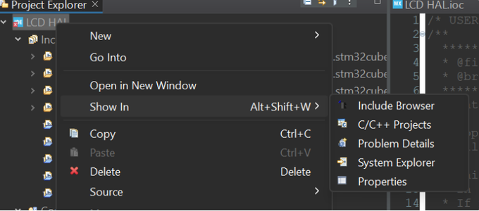

One of the tricky part is that we will require the binary file i.e. .elf file.
For that, we simply open the .elf file created in the system explorer by Right clicking on the project and clicking on show in system explorer and copying the path on the STM32Cube PROGRAMMER.

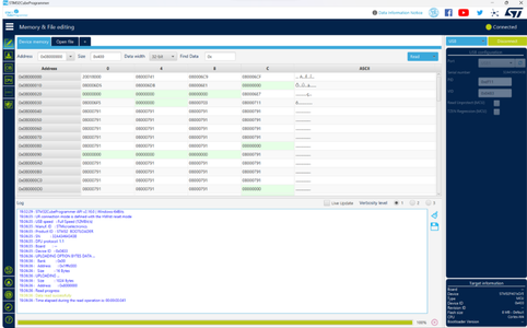

Step 7: EXECUTION!!
In the last step we just need to connect the STM32 Board with the system and upload the code to get the required results.
Step 8: Result
Finally after completing all the steps we will see that the LED on the STM board will blink with a delay of 1 second.
