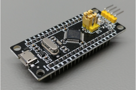

  1. STM32 Black Pill

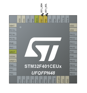

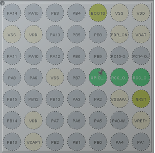

Step 3: Selecting the Pins of the Board
After our STM IDE project is created.
Next step is the selection of pins that we are going to connect the LCD with.
Select the pin B6 for SCL (i.e. the serial clock pulse for synchronous data) and the pin B7 for SDA (i.e. serial data transmission)

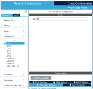

Step 4: Configuring the I2C As Per Requirement
We simply configure the i2c through i2c mode under the "Connections Menu"

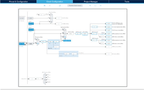

Step 5: Clock Configuration
For any synchronous transmission in electronics, we require a clock signal. Creating a clock pulse is quite simple. It is done by clicking on the "CLOCK CONFIGURATION" bar right next to "PINOUT AND CONFIGURATION".
It is one of the most important steps during any task.
The required adjustments in the clock signal are done as per the picture given above.

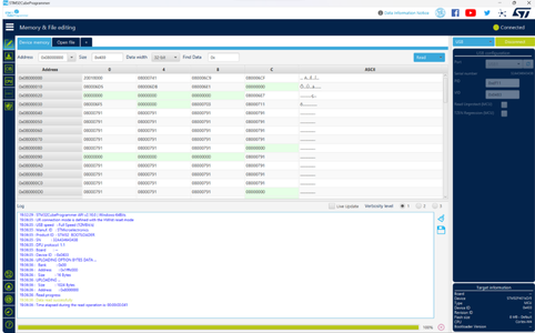

Step 8: .elf File
Next we simply open the .elf file created in the system explorer by Right clicking on the project and clicking on show in system explorer and copying the path on the STM32Cube PROGRAMMER.
Step 9: EXECUTION!
At last, connect the STM board via a USB and open the file and paste the copied path.
Step 10: END!
NOW just download the programs as per the instructions shown above and the results can seen.
