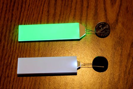

The LED Backlights are available in White from Adafruit.com for about $2.50 each. This LEGO project features the medium size white Backlight which is approximately 1-inch wide and 3-inches long.
The backlights utilize HDTV-type technology to evenly spread out the light from a single LED. As such these LED's can be tested as simple "LED throwies" with a 3-volt CR2032 button battery, as shown. During your testing, be sure to note which side of the backlight is lighted and which side is dark. You can make a note with a Sharpie marker to say "back" on the back or dark side.
Surprisingly, a single CR2032 battery can keep the white LED lighted for almost 2 weeks, although it will dim with time. For further background on LED throwies, be sure to see the classic LED Throwie Instructable.
The green backlight above is special order, but illustrates that brilliant colors are possible by changing the color of the LED light source. Until such colorful backlights are available on the market, gel color sheets can be used to add color to Adafruit's white backlights. Also note that Sharpie or Erasable markers can easily be used to make your "Boo!" lettering, although I have been mostly using stick-on letters.

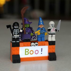

The basic idea is that a 5x12 LEGO box provides a nominal 1x3 inch hole that perfectly holds the LED backlight, as well as several different types of battery holders for power.
With reference to the above photos, start with a flat 5x12 black LEGO base, which actually consists of two 2x12 and one 1x12 piece in the center.
On top of the black base, place your orange box. The cut-away view shows the height of the box for this project is 4 LEGO units tall. Next you will need to insert four LEGO pegs, which as shown in the cut-away view, is used to elevate the backlight to the exact top surface of the orange box. The pegs are about 2.5 LEGO units tall, by use of the red end caps.
Next, to finish out the functional part of the box, two 2x4 orange base pieces are used on the ends to hold the backlight into place.
Finally, round up the likely suspects (ghosts and goblins), and let your own artistic talent (and available LEGO pieces) guide you to finish the project. This project was built from random pieces we had, so I cannot advise a specific LEGO set. See later examples made from a specific LEGO set. Note the orange box for the LED can optionally be made taller, to provide a deeper box as needed for options such as a 2xAAA battery holder and so on.

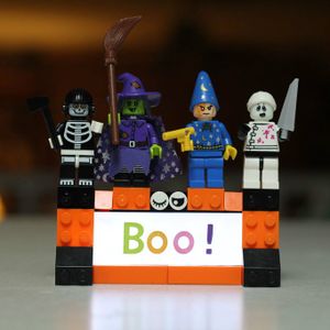

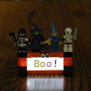

In order to fit easily into the LEGO box, it is imperative that the LED Backlight's wire leads are bent back sharply to the back, as shown. Using wire cutters, shorten the LED wire leads in preparation for soldering. Also using wire cutters, shorten the battery holder wire leads, but leave a loop or slack for stress relief. Solder the battery holder wire leads onto the LED wire leads as shown. Preferably the back side of the battery holder (with the screws) faces the back side of the backlight , as shown. Although its always important to maintain proper +/- polarity in your wiring, if you get it wrong, you can simply put the CR2032 battery into the battery holder backwards. Now turn the battery holder switch to the "ON" position and check for proper LED light operation.
Once assembled, the "Boo!" lettering can be carefully applied, using a straight edge for guidance. Be sure to center the lettering, and keep it within the lighted window boundaries of the box (you don't want the lettering to get covered by the LEGO end pieces).
Finally place the LED/battery assembly into the orange box, such the LED backlight rests firmly and level on the support pegs. A toothpick may aid in lining up the battery holder, and can also be used (as shown) to access the ON/OFF switch.

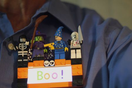

Step 5: Use Stick-On Magnet to Convert to Name Tag
If you've ever been to a LEGO or Brick show, you know the display persons hang relatively large LEGO structures on their shirt pockets. This is accomplished by name tag magnets that are readily available, for example, from Amazon.com.
The Boo! LEGO night light is easy to wear as a name tag, but obviously the ghosts and goblin characters will tend to get bumped off. You might consider removing the characters, or gluing them on with SuperGlue.
