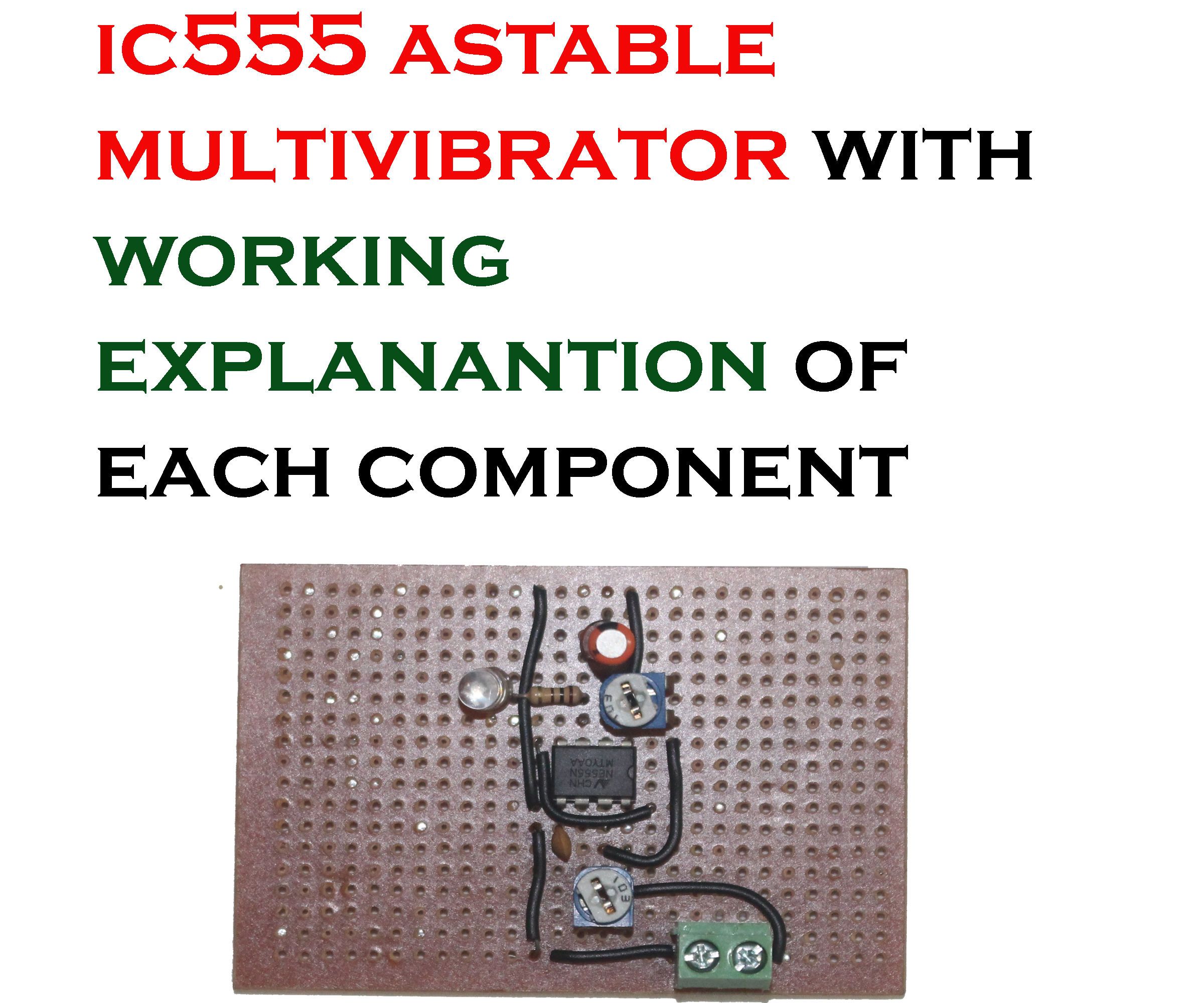

Step 4: Connect Ic555 to Ic4017
since I already have developed astable multivibrator. The output of the astable multivibrator is connected to the clock input of the ic4017. The speed of the running light can be varied by changing the resistance of the ic555. make sure both the circuit have common ground.
Step 5: LED Chaser Working in Different Frequencies
These are the LED chaser with different frequency input. the frequency can be varied by changing the resistance of the ic555.
