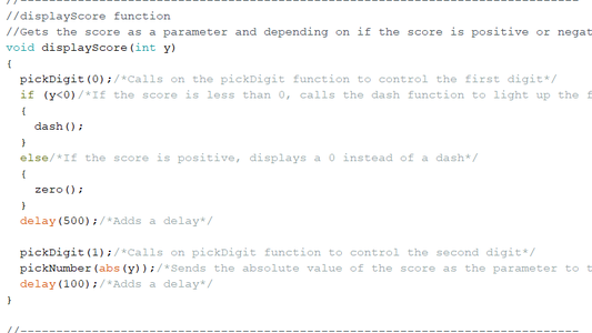

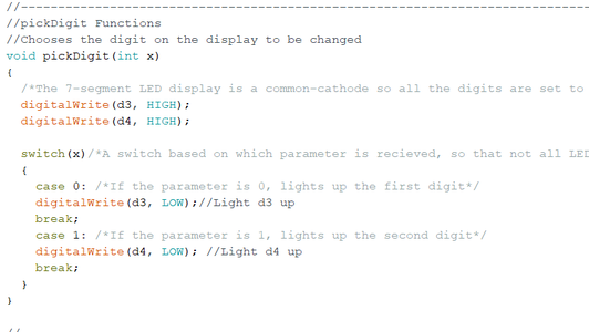

Step 7: Coding: Part 4 (Functions for Displaying the Score)
Now onto the last part of the project, the functions for the score. In the Loop function section, I mentioned a displayScore function. This is first function I will be explaining.
The function starts off by taking the score as its parameter. It then calls on the pickDigit function with a parameter of 0. This function lights up the specific digit that is gonna be changed. Since this function was called with a parameter of 0, that lights up the third digit from the left. Since that digit is now lit up, it can be changed. The next part of the function has an if statement that checks to see if the score is negative or not. If the score is negative, then the dash function is called upon, which lights up the negative sign on digit that was chosen earlier. If the score is not negative, it lights up a zero instead of a dash. A delay is added afterwards. Next, the pickDigit function is called upon again, now with a 1 as its parameter. Since its parameter is now one, the previous digit is turned off from being controlled and the first digit from the right is turned on.
Next, the pickNumber function is called upon with the absolute value of the score as the parameter. The pickNumber function takes the score as the parameter, and calls upon case with the corresponding number. Within each case is the corresponding function that lights up the number. For example, in case 1 is the function that lights up the number 1 on the display. Since the new digit was turned on, the pickNumber function lights up that digit depending on what the score is. If it is negative, the absolute value is sent so that the program understands. Finally, another delay is added, which completes all of the code for this project.
