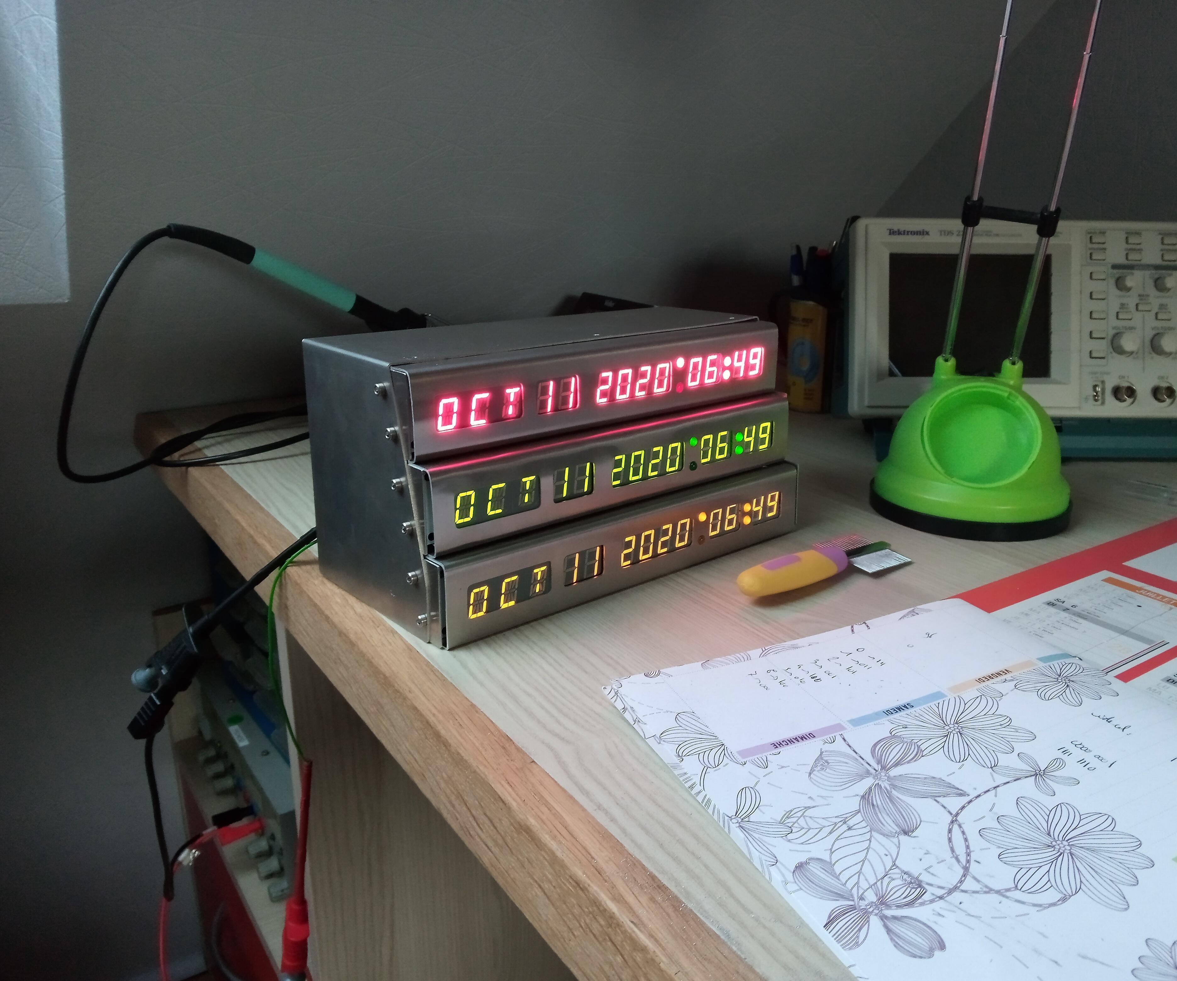

Introduction: LED Matrix
I have made a LED matrix. It's made with 796 red LEDs. The panel is controled by a microchip PIC18F2580.
It can display up to 84 characters (in scrolling mode). In fix mode, it can display 16 characters. Blinking and reverse mode are also available.
