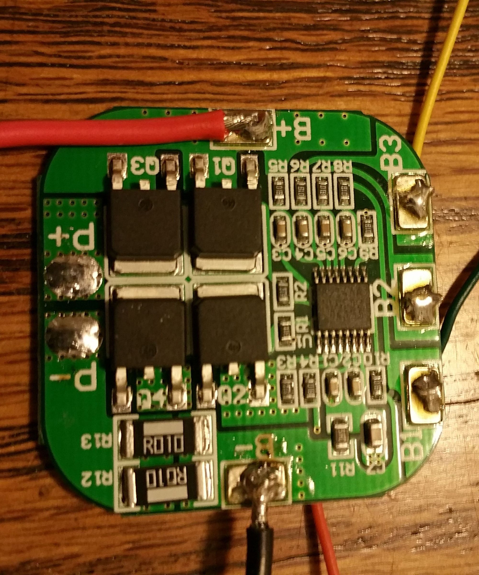

Battery balance/protection board. Get these from eBay or Aliexpress for cheap

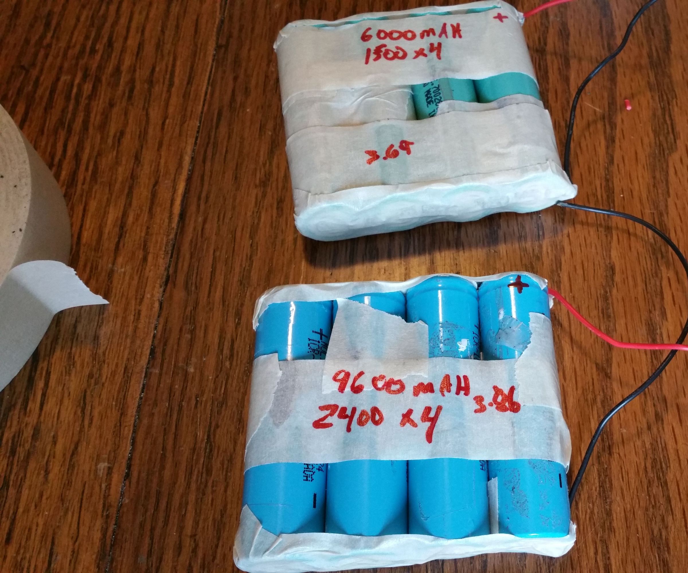

I'm using a 3S2P lithium ion battery pack made from 6 18650 batteries as the power source. I really like lithium batteries because they have higher voltage than nickle cadmium or nickle metal hydride (4.2 vs. 1.5 fully charged), can take lots of current, and have good capacity. The batteries I'm using are Samsung INR 1865025RM, 2500 mah capacity rated at a 20 amp CDR (continuous discharge rating). Since I have 3 in series for 12.6 volts and 2 in parallel, this gives 5000 mah, which should power the light at max power for 45 or 50 minutes. This is more than enough for my purposes. Also, the current handling capabilities are doubled.
You don't need to use a series-parallel configuration. You could do series, or run them in parallel if using a boost driver. I'm using the series-parallel because my driver is a "buck" driver and the battery voltage must be higher than the output voltage. In this case it's 12.6 volts being reduced to roughly 6.5 volts
I made an Instructable on how to build this type of battery pack, so check that one or four more information. Start by building your pack according to your host dimensions. I had to get creative with arranging mine to get it to fit properly. I connected the cells together by soldering, which is not the recommended way, but I didn't have a spot welder. This is why a 40-60 watt iron and good quality lead based solder is essential since a lower power one won't get hot enough to properly solder the cells and you'll apply too much heat trying to get the solder to melt. This is dangerous and can ruin your batteries or even worse, cause them to overheat and vent. Use the biggest chisel tip your iron can take and crank the heat up. Don't hold the iron on the cells for longer than or takes for the solder to flow. Use pure nickle strips for this since the current from the battery will be up to 10 amps when the voltage gets low and it's run on max output. Steel strips have higher resistance.
The photos show the initial design of the battery that used 16 gauge wires to connect the series/parallel cells, but I removed those for the final version and used nickle strips in their place since they lay flat and don't stick out.
Once your battery is together and you check the connections, you're either done if using a single cell or multiple in parallel, or in my case, need to add the battery management system or board (BMS). This is critical in series connections since you need each cell to charge and discharge evenly, and also to monitor the individual cells for low voltage. If you don't use a BMS, then you won't get optimal performance from your batteries and could end up damaging them from over discharging or overcharging.
I also added the balance connector lead which is necessary for charging the cells properly with a balance charger. I highly recommend using a balance charger for li-ion batteries since it will hemp them last a long time. I added input leads for the charging socket and output that run to the driver board. I also added a lead and a 2.1mm JST connector for the cooling fan.
Last step was insulating the bare connections with electrical tape and heat shrink tubing, and wrapping it up in masking tape.

The leads from The charging plug ran to the battery positive and negative output side of the BMS board.
