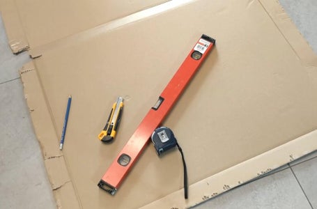

Step 4: Making Shelves' Stencils
The solution for the uneven walls, is to create a stencil using a cardboard.
I cut 3 pieces of cardboard as can be seen in the pictures. I put the bigger piece in the niche and 2 smaller parts pushed to the wall on both sides to fit the wall's angle. Then I connected all of them using a stapler.
