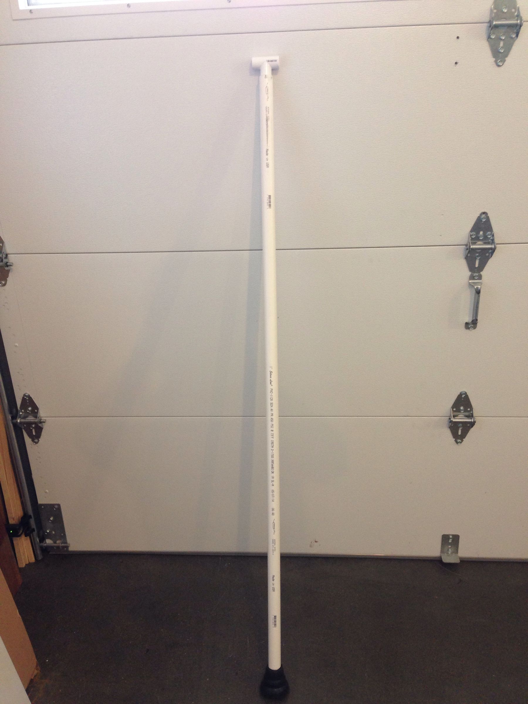

2 one inch PVC Tees - slip over style. These tees slip over the top of the PVC pipe
2 one inch PVC to 1 inch Hose adaptors. These slip over the bottom of the pipe and get pressed into the toilet plungers.
2 black super suck heavy duty plungers. See picture for the style I used.
See picture for my costs at Lowe's.
We will not be using the plunger handles, but you may want to save them and use 'em as weapons when you're out riding - take out your opponents with a swift strike to the back of the knees.

Also cut off the end of the plunger. I used a box knife for this task, but you can also use the hack saw.
Watch where you put your other hand when cutting!!!!
We will keep the thicker end for the bottom of the paddle.
Step 3: Assemble!
Push the adaptor on the other end of the pipe.
Push the barbed end of the adaptor into the plunger and smack the whole thing on the ground a few dozen times to ram the adaptor into the plunger.
