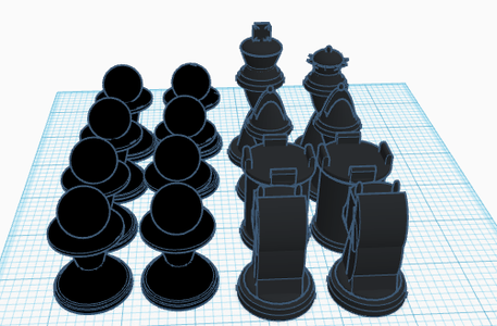

Step 1: Making the Pieces
To start your chess set, you are going to need chess pieces. Linked below is a downloadable file for those pieces. Save the file to a hard drive with a removable disc. Next, slice the hard drive with 3d editing software, ensure you have support, and set the support to everywhere. Lastly, remove the removable disc from the hard drive and insert it into your 3d printer, make sure the printer is leveled properly and press begin. Print twice with different colors.
