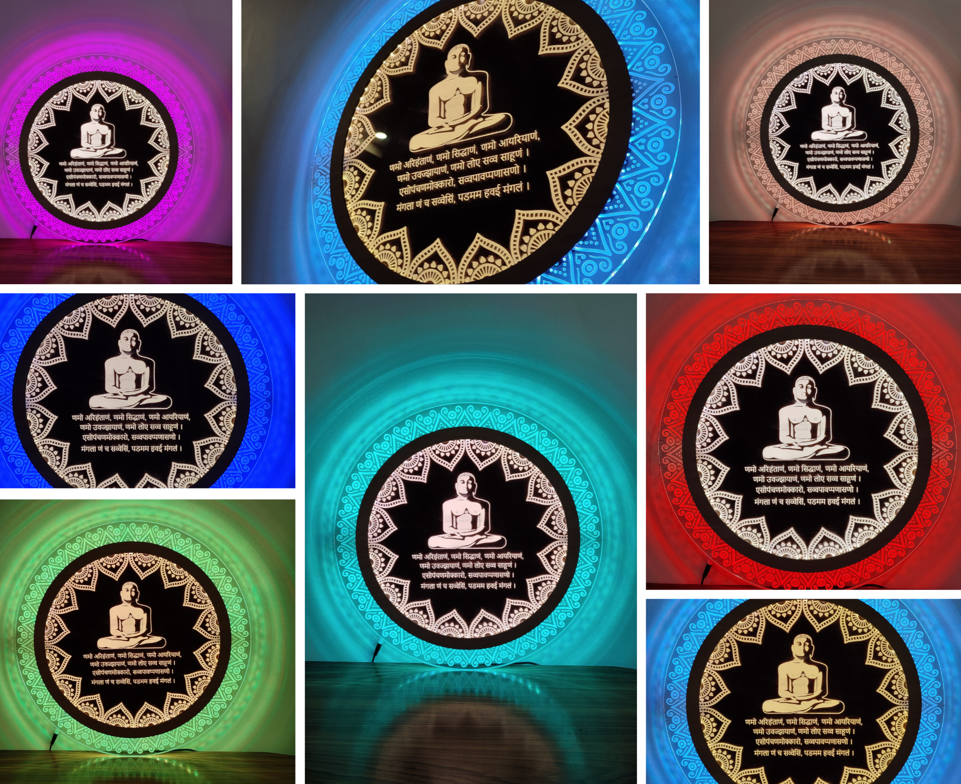

Step 3: Laser Etching Acrylic
Glowing part of this night light is made out of acrylic. Instead of acrylic, glass can also be used.
Now if you have never used a laser cutter before let me tell you its the most amazing tool for the makers and is very easy to use. You can sign up for Instructables Laser Cutting Class. Its very well designed with lots of information and projects.
- I downloaded the graphics from vecteezy.com and imported it in RDCAM. This program is used to do all setting including laser power, speed, alignment to operate laser cutter. I also added a text which says 'Some people learn to dance...others are born to.' All aditions are done in RDCAM only.
- Once file is designed I made a mirror image then processed it in laser cutter so the engraving is done on the backside of the sheet and front side will stay plane as it is.
Make sure to add an inch at the bottom as this will go into the slot of the stand and not be seen.
You can download the final file here.
