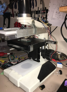

Pic 1 and 3 shows the model I work with right now. It was in the beginning of my project development a more chaotic contraption, but it did work fine!
Before you start building, a word of advice (pic 4): since this device's main part is a laser and the whole thing operates by means of concentrating and redirection by lenses and mirrors, of laser light, you have to be extremely carefull and take precautions for yourself an any bystanders not to stare directly into the beam or any reflection of it.

Step 8: Putting Things Together
On pic 1 you see one of my first contraptions. As you can see it's a little bit chaotic, but it did work rather wel. On the picture you see my son's little microscope I had borowed (for the vertical movement of the object, to make focussing easier), the crocodile clamp with the the PCB holding the lens, the blue tube (ball point housing) containing the LDR, the laser attached with magnets to a CD/DVD lid that on his turn was clamped to a wall shelf, and a whole microscope slide in an angle of 45 degrees to act as a semipermeable mirror. Okay it is'nt an ideal situation, but if you have nothing else for the time it's workable. But be sure that the lens moving plane is parallel with the object table! Then you are ok for now.
Here you see also one of my green lasers, who now is resting in peace after I abused him til dead with 22 Volts instead of 3 V max! He did'nt like that at all! That was a pity because this laser had a very nice round spot and was very good focusable. An other green laser had no good internal optics and therefore not good focusable. I use now a blue laser with even better results. So you see: you have to experiment a little with differend lasers to see wich is the best. By the way, a round laser spot is'nt necessary, rectangular wil do nice.
I use a ball point housing (with the tip a little bit bent) to put the LDR in. It fits snugly and if you put the surface of the LDR a little bit deeper than the edge of the ball point housing you have less stray light hitting the LDR. Make sure you first solder longer leads to the LDR (pic 2).
The close up of pic 3 shows the LDR in the tube, slightly sunken (to prevent stray light).
I've made the semipermeable mirror out of a thirth part of a microscope slide (any little piece of glas wil do) glued to a piece of foam (the black triangle) what I've cut on an angle of 45 degrees (pic 4).
On pic 5 the mirror is in it's place. It's situated above the (black)hole where the laser beam travels through. On the left you see the LDR housing with a piece of aluminum foil. In this foil I have punched a hole with a needle. I explain later why I use sometimes needle punched aluminum foil.

Very nice project. I am playing with this opus for a while and when looking and your pictures, I noticed that the your pwm output signal is not filtered well enough. Solution would be a better filter, but that could reduce the bandwidth of the output signal to much. So a decicated high resolution dac with amplification worked best for me and cost only a few dollars. For focusing I missuse the PDIC and the red laser on the opu running an control loop on an fpga - the important thing to thing about here is, that the cd/dvd/bluray disc first layer is an optical part of the whole opu system. If you just skip this part, the laser can't be focused on the PDIC anymore and it will never work. When you get it working you will never want the final fine adjustment to be made manually... Keep up man this opus are amazing :D
