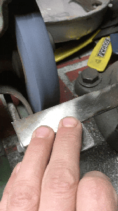

Step 3: Grind Into Final Shape

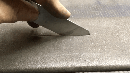

You have the rough cut out of your parting tool now, but it needs refinement. Nibbling away at it with a grinder works great - go slow and don't take off too much at a time. You can check if the edges are flat by placing against your workbench (if that is flat, a straightedge or file if not). If there is light in between the metal and the bench, it needs a bit more shaping. This part can just as easily be done with a file instead of a grinder.

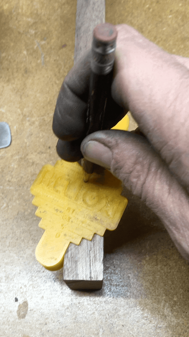

Step 5: Cut Out Handle Template
My piece of scrap was the perfect thickness for this project. I used one of my favorite 3d printed woodworking tools - this tracing guide - to mark the center of the scrap. I then traced out the knife part onto it, leaving about an inch past the end of the tang for the handle - you don't want to cut a slot all the way back if you want a longer handle enough to make it usable. I rounded the back of the blade tang, which you shouldn't do if you don't want a little gap where it fits in the slot - it doesn't impact performance, just leaves a bit of a gap.
I used my bandsaw to cut the slot for the blade, then cut around the shape of the handle. A coping saw could also work for this, it will just take a lot longer, especially with a hardwood.
