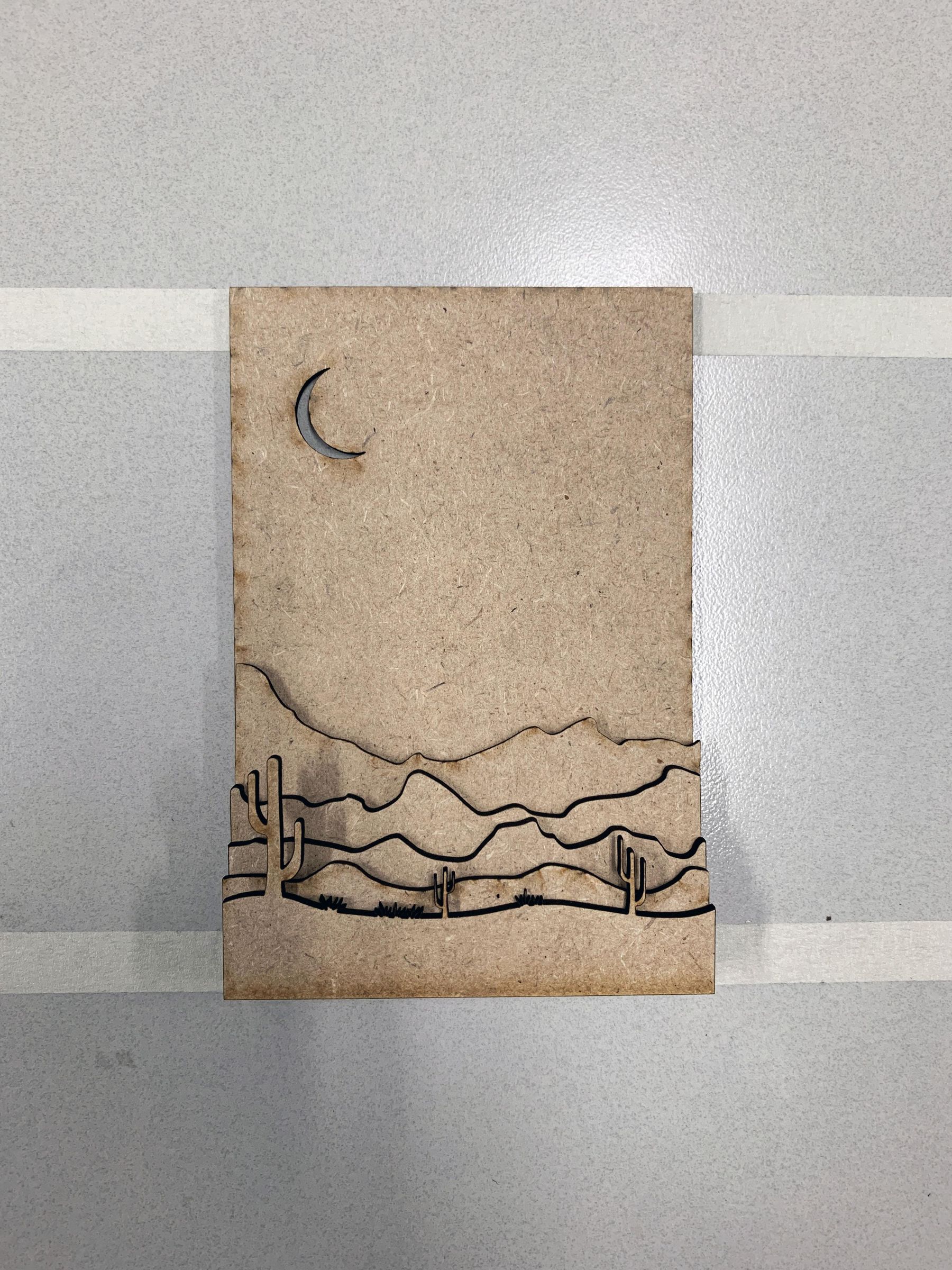

In this project, I created a Layered Landscape using the Cricut Explore Air. I followed an example Illustrator drawing tutorial from Blog Spoon Graphics using Adobe Illustrator. I then turned into a project that could be fabricated using the Cricut Explore Air. This was an example project for my HS Digital Fabrication course for studnets to follow as they create their own Layered Landscapes.

Organize each of the indiviual pieces of the landscape into sepearte layers. This one has a total of 6 layers including the background.
Each layer should be a closed and continuous vector. Each layer (except the sun) also extends to the bottom of the page. This gives space for the layers to be gluded together.

Step 11: Stack the Layers and Finish!
Take each of your layers and stack them together. Use glue between each layer to attach them together.
