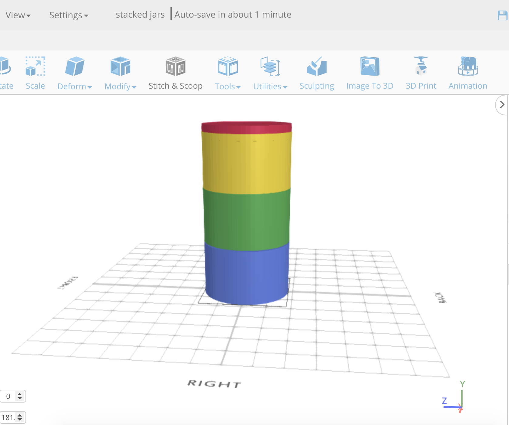

So what’s cool about this tool is that you can keep increasing segments and alter them uniquely.
Each time you add a segment you can alter many things on it and play around with all the different features to slowly build a tower of your finished project.
Also the program automatically duplicates your first segment as your second so you can zero it out and start fresh or base your next piece off of your previous one which could be really helpful.
For the bevel feature you can choose a top and bottom level and then the computer will figure out the rest for you based on the weight you choose.
The same idea is used for the position offset by creating a transition area of smoothness.
Once you have segments, at any point you can toggle back or forth by using the arrows on either side of the segment drop down and change other parts to keep adjusting for other parts which I think is a really cool feature.
