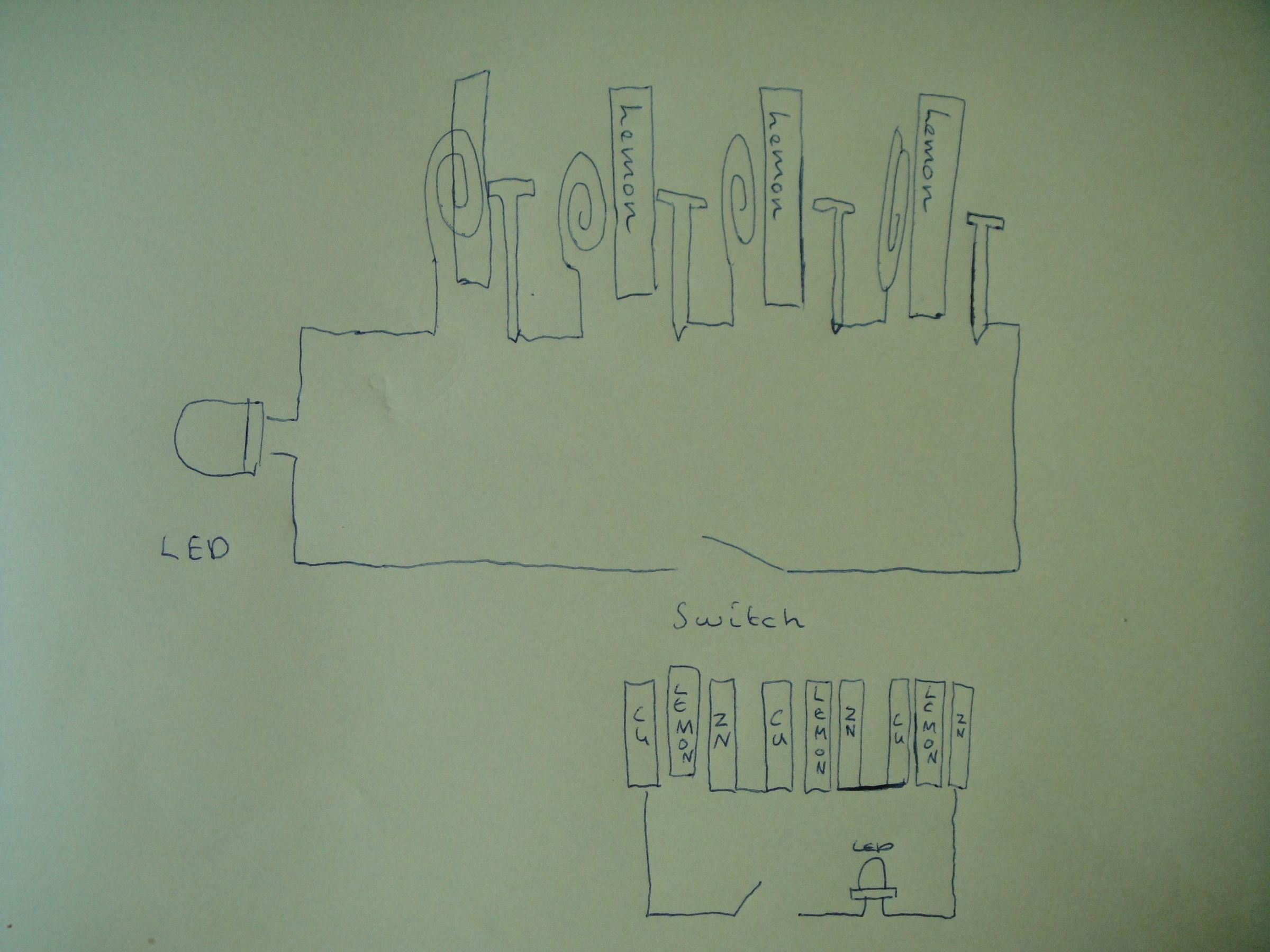

    spark master
    spark master
    12 years ago on Introduction
    I like it, but have a question. shouldn't the nail NOT touch the copper coil ?
    0
    scraptopower
    scraptopower
    Reply 12 years ago on Introduction
    It should, in my opinion. It's like sticking a nail and copper in a lemon and then connecting it in series to another lemon. The copper in one lemon is connected straight to the zinc in the next lemon. Each coil and nail is like that.
    0
    spark master
    spark master
    I need to relook it over. It makes sense as you said it here, but not apparent(for me) in the actual instructable. I am sure the not seeing part is my error not yours. I do understand the concept though and that is what I thought you were going for. What confused me to no end was the copper connected to the nail itself, and the insulator sheets. The lemons can touch then metal cannot, although I believe in a car battery (wet cell) the acid is contained in X number of separate cells. When the price of lemons goes down I will ltry this, or use sponges and vinegar. I like instructables enough I may pay for it, eventually. It goes hot and cold with cool stuff . This uis pretty elegant for such an easy thing. sparkie
    0
    scraptopower
    scraptopower
    Thanks spark master. A car battery was my inspiration for this as it has many separate cells connected together. The separators are to stop the  lemons touching each other with I think will short out that cell (not sure).
    I've added a drawing which might help:
