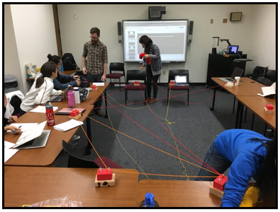

Step 4: Game Set Up
  • The teacher gathers eight anchors, such as boards with nails in them, and several spools of differently colored yarn.
  • The teacher places eight anchors around their room so that the anchors serve as vertices of a regular octagon.
  • Finally, the teacher should develop a series of challenges and constraints for the game. Examples include:
    • CHALLENGES - Make two non-congruent triangles, Make a free floating kite
    • CONSTRAINTS - Include at least 5 separate vertices, Cannot include two shapes with overlapping lines
Step 5: Choose a Game Mode
Competitive mode walkthrough
  • First, students form groups of two to four.
  • The teacher then gives the class one puzzle to solve that involves the use of geometry terminology.
  • The teams discuss how to interpret the puzzle (looking up terminology as needed), then race each other to see who can accurately solve the puzzle first.
  • Teams use their skein of yarn to place lines between anchor vertices.
  • Teams may need to justify how their shape or design meets the challenge or solves the puzzle. Multiple interpretations of the puzzle are allowed, per the teacher’s judgement.
