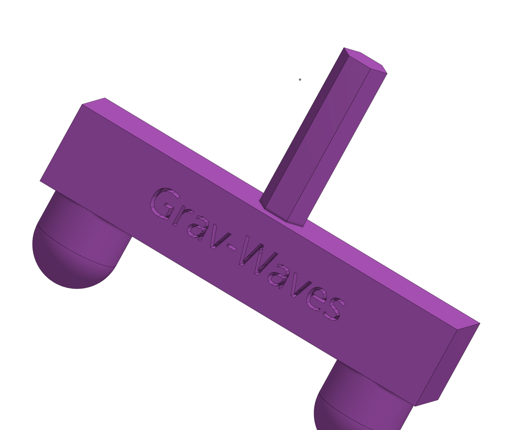

Start by 3D printing the LED holder. This has a pair of clips that go into the top of the module and can be removed at any time. If needed, the STL can be modified to increase the emitted light.
