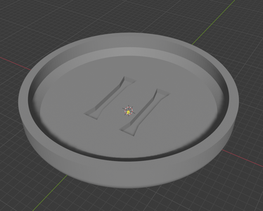

First, I started thinking about what kind of buttons I would use for this project. Initially, I wanted to use traditional Sanwa arcade buttons, but those are far too tall to fit in a slim form-factor. I decided to use Kailh low profile chocolate switches, clear red ones specifically (see first attached image). These can be purchased at splitkb. I used choc v1 switches, but I heavily recommend using choc v2 switches. Mainly because the v1's have very unorthodox pinholes for fitting on button caps, and pretty much my only option for button caps was to 3D print them myself, whereas if you use the v2's, you get the advantage of having the cherry mx style cross pins. So you can fit on pretty much any keyboard button cap you can find.
After purchasing my switches, it was time to start work on the button caps themselves. This was a difficult process which even now I am not entirely satisfied with. At first I tried a design where the pins were a part of the cap, but due to them being printed up-right, this cause for inconsitencies between prints and they would rarely fit on the switch (see second attached image). Eventually what worked for me was printing the legs and cap seperately and glueing them together afterwards (see third and fourth attached images), this was a lot more consistent and was easy to do in larger batches.
I would have liked to work more on giving the buttons a nice finish (some of them are even a bit collapsed), but I was cutting it a bit short time-wise :(

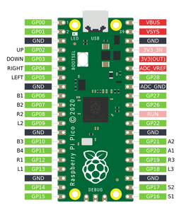

Soldering time! Because I am using GP2040-CE, I can follow their guidelines for soldering the pins to each specified header (see first attached image). I daisy-chained all the ground wires to one gnd pin on the Pico, and the rest to their corresponding pins (see second attached image for a diagram, third attached image for the finished soldering work).
