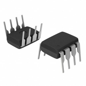

LM741 Single Operational Amplifier (555 timer)

Figures 2 and 3 give a better look at how to connect the wire to it as it might confuse you. As the diagram in Figure 3, pins 1 and 2 are connected to the negative (ground side), and pin 3 is the output. Changing the resistor value from the dial button on the potential will affect the sensitivity of the circuit (explanation in step 2).

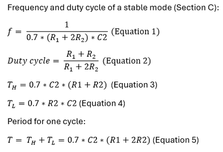

Also, we can calculate the time high (TH) and time low (TL) of the output (bottom) graph in Figure 1, by using equations 3 and 4 in Figure 2.
The output of the 555 timer connects to the speaker (Section D), we want the speaker to produce at the frequency that the human ear can listen. The normal range for human hearing is from 20 to 20,000 Hz. By using equation 1 in Figure 2, with values of resistors 1 and 2 (R1 and R2), and capacitor 2. The frequency of the circuit is 340 Hz so we can listen to it. The duty cycle is 76%. The duty cycle means the percentage of the circuit stays high for the total period. In this case, the circuit stays high at 76% of the total period.

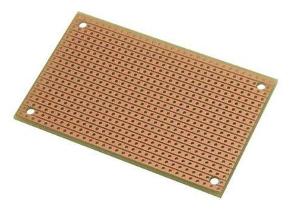

In this experiment, I utilize the breadboard due to its convenience in verifying the functionality of the circuit. Various types of circuit boards can be chosen for different applications, such as prototype boards for the physics lab (Figure 2) or perf boards (Figure 3). When using perf boards (Figure 3), proficiency in soldering components is necessary. Unlike the plug-and-play nature of the breadboard and prototype board in Figures 1 and 2, soldering skills are required."
"When constructing the circuit, employing certain tips can enhance the process. Color-coding the cables facilitates easy tracing in case of circuit malfunction. Additionally, ensure that the cables are securely connected, as loose connections can lead to issues, as I experienced with my breadboard.
Moreover, both breadboards and perf boards offer the advantages of being highly accessible, cost-effective, and flexible in circuit prototyping. They allow for quick experimentation and modification without the need for specialized equipment since the perf board can break into small pieces depending on how big you need the circuit to be, making them ideal choices for both beginners and experienced hobbyists alike.
