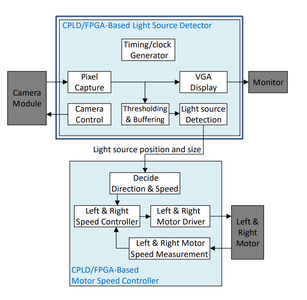

Light Seeking Mobile Robot is able to move back-forth and left-right (including rotational movement) according to the condition of the light source point. All decisions on the robot are the result of logical thinking that has been input on the Basys 3 board with the VHDL code.
BASE 2023 LC-71 divided into 2 groups, “Light Source Detector” and “Motor Speed Controller”, the 2 groups contain 5 divisions on Light Seeking Mobile Robot :
  • Timing/clock Generator - VGA Display
  • Pixel Capture - Camera Control
  • Thresholding & Buffering - Light Source Detection
  • Decide Direction & Speed - Left & Right Speed Controller
  • Left & Right Motor Driver - Left & Right Motor Speed Measurement
Step 4: Light Source Detector
This group has the roles to reads image from camera, thresholds and buffers the image, detect light source position and size for the motor speed controller. It also outputs captured pixels to a VGA display.
For more details you can refer to page below :
Step 5: Motor Speed Controller
This group has the roles to decides the target direction and speed of the robot based on the light source position and size, measures the speed of the two DC motors with position encoders, also control the speed of the two DC motors and drive the DC motor with PWM signals.
For more details :
