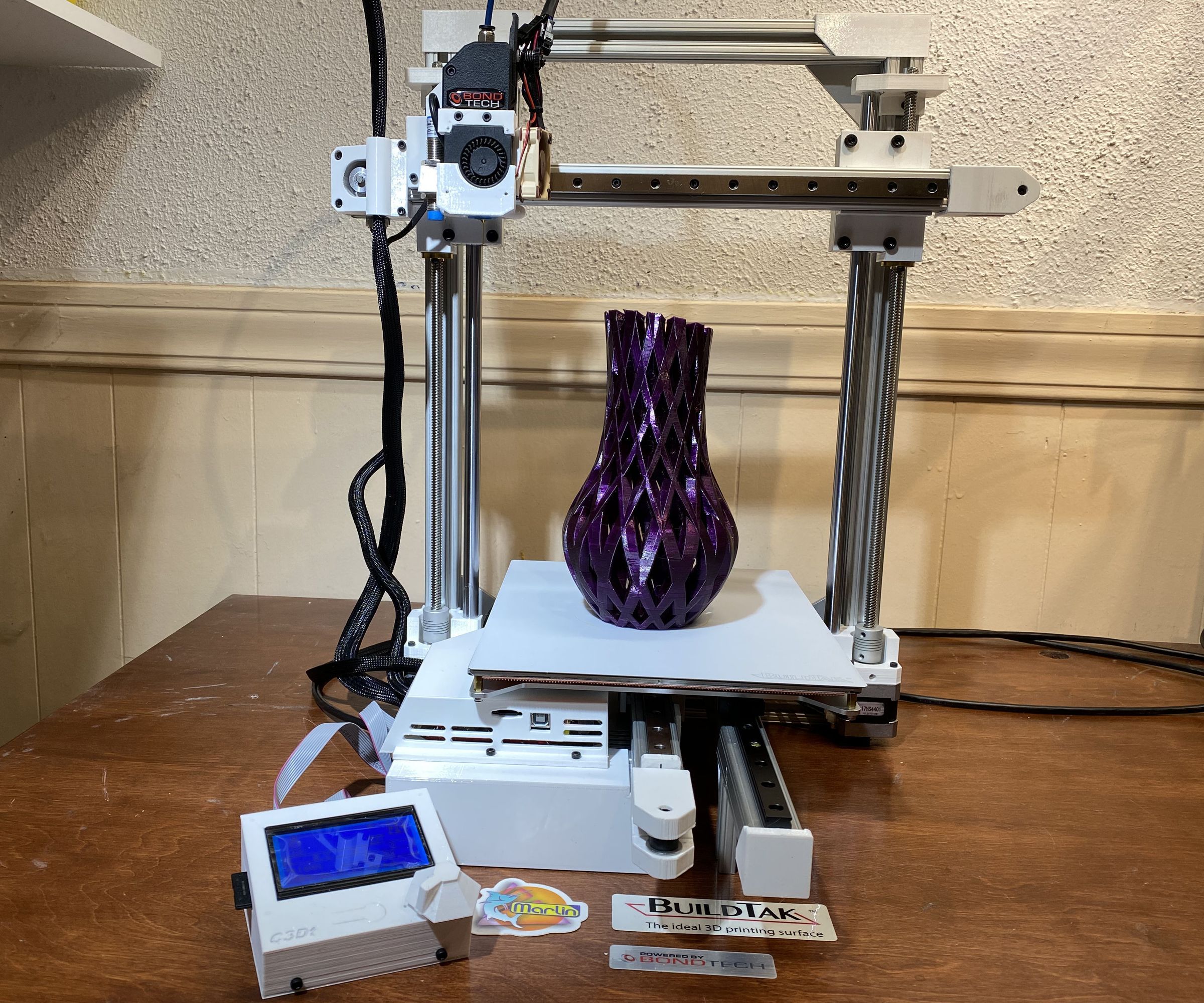

The original screw driven rail lends itself nicely to having one of each on each side of a 3D printer. Up and down is accurate but BY itself, it doesn’t have a lot of lateral support.
Since I’m looking into cantilever designs, I revised the rail to introduce a second linear rod, widening and thus stabilizing the linear screw. I intend to use this implementation in a revamp of my Cantilever printer

This Axis was used for the C3Dt/c Printer, and below is the assembly video created for this axis:

In case you're wondering what you can do with this component check out this video
