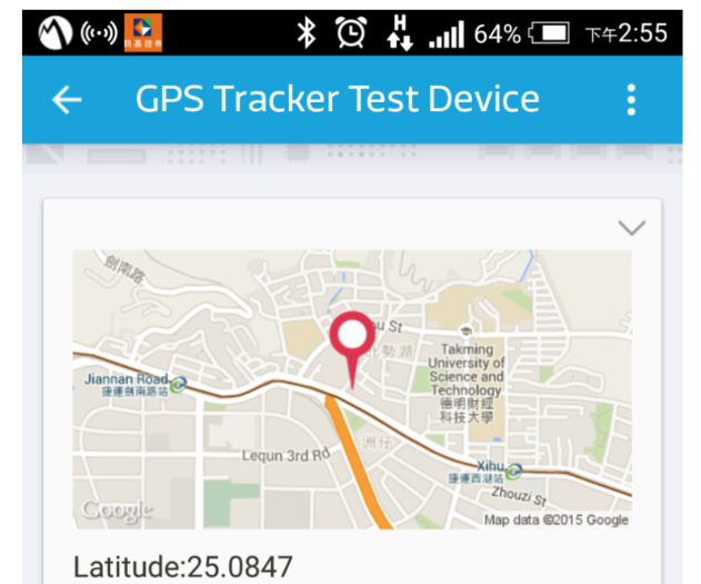

Upload the code at STEP 1. You can open your MCS page by browser.
After about tow minutes, you can see the GPS data is uploaded to your MCS. Come on and get a LinkIt ONE!
