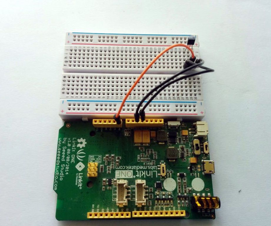

Step 2: Schematics
The schematics for are similar to that of the previous instructable, make sure you are using a servo which is compatible with the Linkit One.
The schematics can be found in the picture above, I had to use an arduino to represent the linkit one as Fritzing doesn't have a library for the Linkit one yet.
