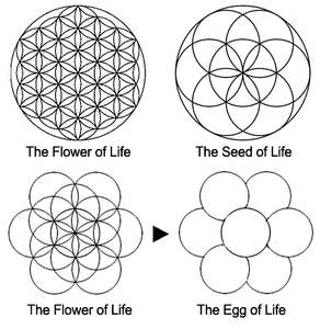

I embarked on an exploration of what a living wall could be... I settled on 2' square vertical wall with a center design influenced by sacred geometry, specifically the "Flower of Life".

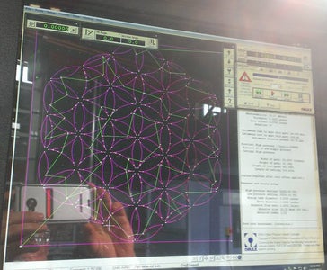

Step 5: Waterjet Cutting the "Flower of Life" Into 1/16" Thick Steel Sheet
I cut the design using the Omax waterjet. The Cut file was the most challenging given the 64 individual cutouts, mostly straightforward removing pieces as the cut progressed. Files attached - enjoy :)

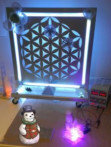

Step 9: Lighting Up the Wall
I attached a strip of Non-Addressable RGB LED Strip to the inside of the Frame. This is powered via a power supply and controlled via Arduino UNO and LumiGeek 4xRGB shield. I am sharing additional information regarding the Arduino / LumiGeek setup under a separate Instructable; for additional information on LumiGeek go to LumiGeek.com or https://www.facebook.com/lumigeek.
