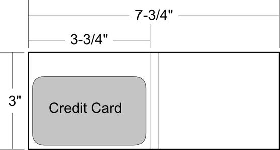

The first thing you'll want to do is decide what is going into your wallet and what the critical dimensions are. Today we're making a simple bi-fold wallet with pockets for cards and bills. A standard credit card is 3-3/8" x 2-1/8". Add a seam allowance of 1/8" to each side and 1/*" for "wiggle room", and we find that we need at least 3-3/4" of space for each pocket. We'll leave 1/4" in the middle to allow for folding. A Canadian bill is 6" x 2.75", so the overall length is OK, and we'll make the width a little bit taller to allow for the seam along the bottom, and a bit of extra space at the top.
Now here's an important tip: These are the dimensions for the inside of the wallet. The outside piece of leather will need to be about 1/4" longer, due to the thickness of the leather. It seems obvious, but it's easy to forget about this until your leather is cut and it's too late.

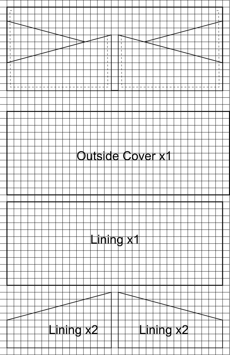

Draw up a complete pattern on paper, or use a drafting program and print it out. Hang on to this "master" copy to verify all your pieces are cut correctly.
I went ahead and added two overlapping card pockets on each side. The angled tops are just a style choice I like to use. Make them square if you like. Just be sure that enough of the card will stick out to allow you to remove it!

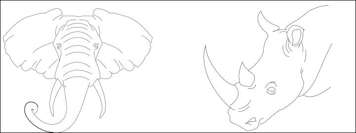

The next step is stamping. First, thoroughly dampen the leather with a sponge. Wait about five minutes until the surface returns to it's original colour. This procedure is referred to as casing, and can be tricky. You want the core of the leather to be wet, but the surface dry. With experience you will learn exactly when the leather is ready.
Next, use an edge beveller and mallet to push down the edges of your lines, creating a 3D effect. There are hundreds of different stamping tool shapes, but most of the time, I just use the edge beveller. You can use just about anything to create a mark. Coarse sandpaper creates an interesting texture. The end of a wire or dowel can be used for circles. Use your imagination.

The pattern in step 2 has dashed lines indicating where the stitching is done.
