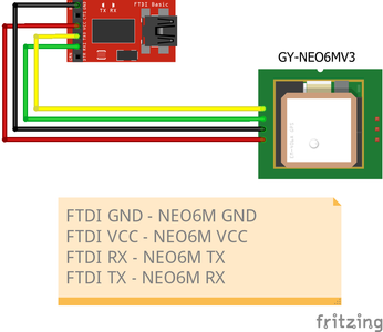

Step 1: Step1: Connect Up the GPS and USB-Serial Converter
First you will connect up the USB-Serial Converter and GPS Receiver in the following way.
USB-Serial VCC -> GPS VCC
USB-Serial GND -> GPS GND
USB-Serial TX - > GPS RX
USB-Serial RX -> GPS TX
Note that the TX of the USB-Serial goes to the RX of the GPS and the RX of the USB-Serial goes to the TX of the GPS.

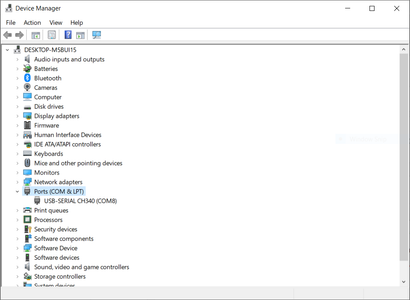

Step 2: Step 2: Connecting to Your Computer
Attach the USB cable to your USB-Serial converter and plug it into the computer.
Find out which port your device is connected to by using the "Device Manager" under "Ports (COM and LPT) if you are using Windows or if using Linux listing the devices in /dev/ttyACM* or /dev/ttyUSB* to find the appropriate COM port.
