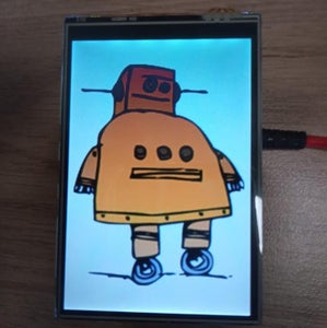

Browsing on Aliexpress, I found this cheap 3'5 TFT SPI touch screen, interested in using it in future projects, I bought one.
As its installation and use were not seamless, I decided to make an instructable about it. I have not used the touch part yet, but that may come later. This is my first instructable and English is not my native language, so please be indulgent.

After the boot, you should see the boot messages on your LCD screen. So far so good: it means your screen is working correctly.

  • fbbmp: reads a 480x320 24 bits bitmap and displays it on screen.
you can try
./fbtext --t "Hello !" --f 6
./clearscreen
./fbbmp sample.bmp
./clearscreen
