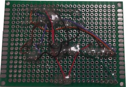

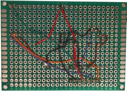

I tried various positions for the components before choosing one. Then connected the whole, ant it as time from wrapping and soldering.
Front face is OK. Rear face is always spaghetti like.

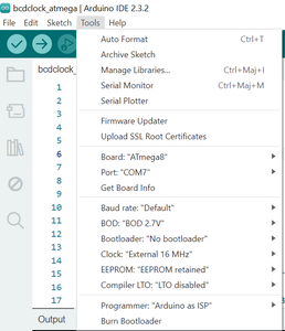

On your Arduino IDE, you will need to install the Minicore board manager, just follow the instructions here :
https://github.com/MCUdude/MiniCore#how-to-install
Set the board to ATMega8, the frequency to 16MHz ( unless you chose an other quartz frequency ), the programmer to "Arduino as ISP", and the Bootloader to "No Bootloader".
Here is a simple blink program for port D13

You need to use the "Upload using Programmer" command instead of the standard "upload".
