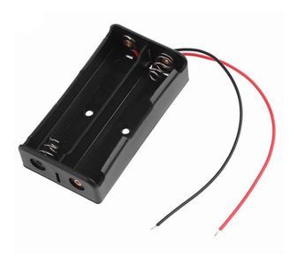

  • 2 batteries of 3.7V 1A
  • Battery holder

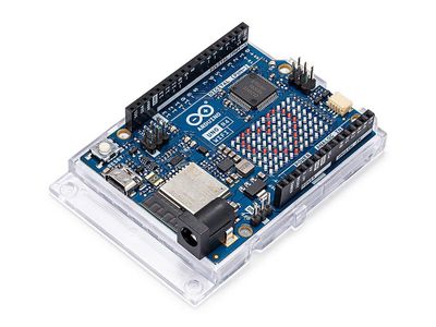

  • Arduino Uno

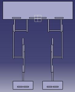

Step 1: Sketch
First of all, we have to do some sketches that will give us the ideas for the final product. In our brainstorm we analyzed which movements the robot has to do in order to replicate the gait cycle, then we started with the general sketch.
In order to have a better balance, we increased the supporting base, and closed the gap between the two lower limbs.
Step 2: Modeling (CAD)
With the ideas recollected on the brainstorm and sketching, we started modeling the exoskeleton. In order to do this, we used the software "CATIA V5".
For the part that will support all the electronics, using the software "SOLID WORKS 2022" a base was designed in order to provide a proper space for the batteries, the Arduino and the protoboard parts.
Step 3: Cutting
With the exoskeleton design in CAD, we convert it to dxf and then cut all the pieces using a laser cutting machine

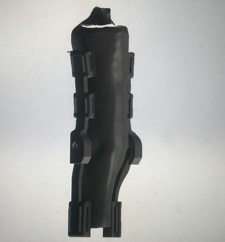

Step 4: 3D Printing
Now, with the base designed in CAD, we printed it on a 3D Printer "Ender 3 pro".
Step 5: Assembly
First, the parts that are not mobile are assembled and attached, such as the feet and hips. Afterwards, the motors are placed in the squares that were left in the Catia. And in the joints with four nails, the part that connects with the servo is placed. At the end, we assembled the 3D printed base on top of the exoskeleton.

Step 7: Electronics
All the electronic components should be wired as it is shown on the images. The six servomotors have three pins, one is connected to ground, the second to voltage and the last one directly to the Arduino's pins. It is important to use a protoboard in order to not cause an overcharge on the components.

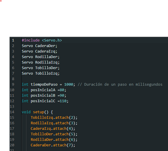

Step 8: Coding
The coding was made on the application "Arduino IDE 2.3.2", it moves the exoskeleton as if it was a real person, recreating the gait cycle on scale.
