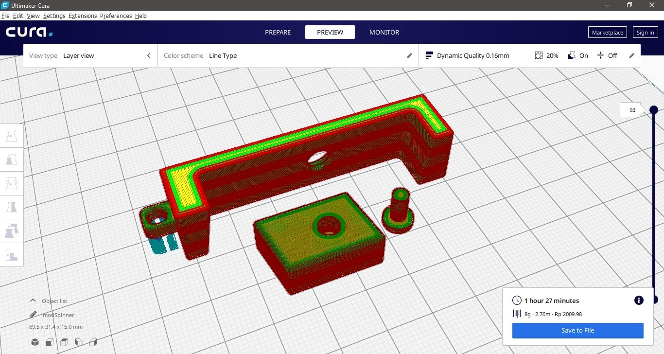

Made of three parts and easy to assemble without manuals when you see the cover photo. Align the holes on both the body and spinner then plug the pin inside. Those three parts can be printed at once with orientation like this :
I use Cura slicer and some important settings to check are :
- Layer height : 0.16 mm (this affected the pin and hole to be plug-n-play).
- Infill : 20% (doesn't really matter anyway, but more infill = more rigid = more steady).
- Support : Yes. Touching buildplate only.
The rest of settings depend on your material and preferences.
