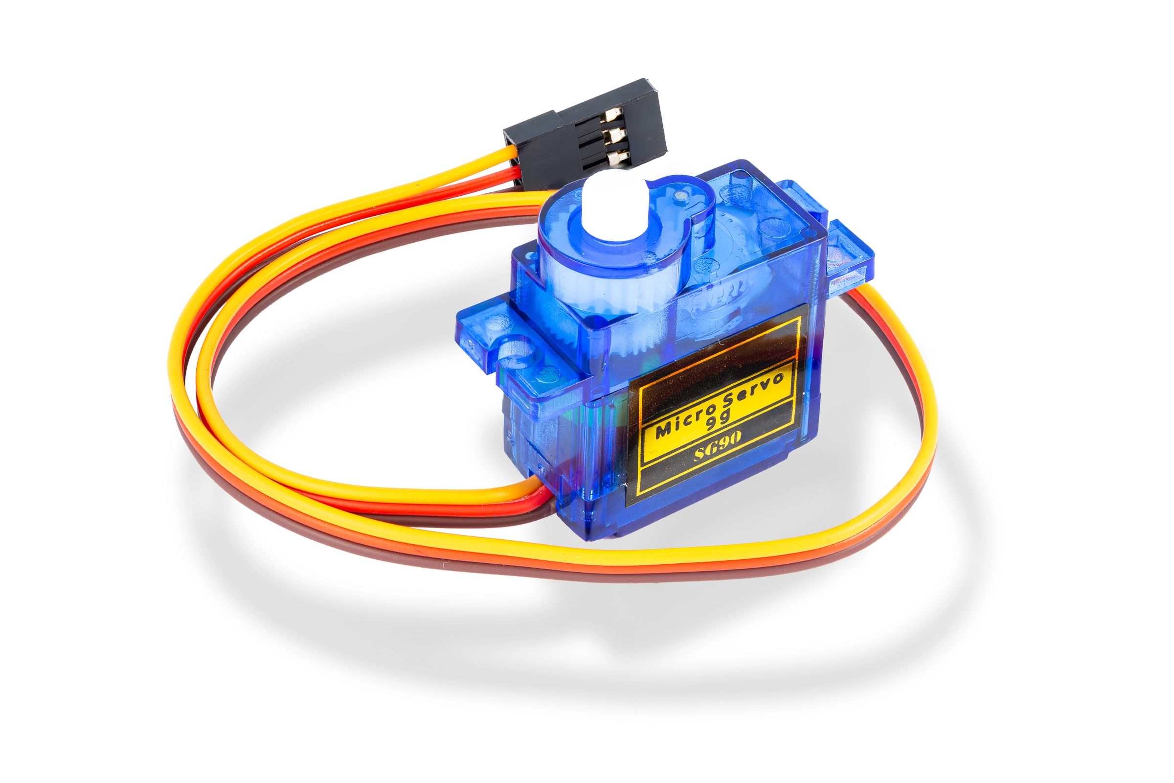

  • Servomotor

For the stir, we use an Arduino. We use a potmeter and connect it to a servo with a simple program and an Arduino Uno. The program I used is attached to this step. You can use a breadboard to get a better and more organized view of your project.

Make some holes at the end of the large tube to put the servo in the hole. You have to adjust the hole to the form of the top of the servo. Only the turning point of the servo has to be out of the submarine, the body of the servo has to be in the submarine.
The output cable has to be long enough. I used +- 2 meters of cable. Put some zip-ties on the cables to keep them together and to make it look cooler. Make a hole in the middle of the large tube and make it big enough to feed all the output cables through. Connect the cables from the 2-way buttons to the copper tape and the cables from the Arduino need to be connected to the servo using some luster clamps.
