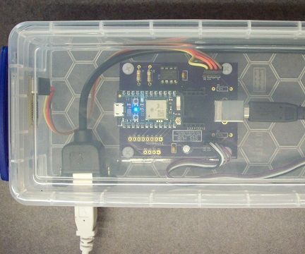

Step 1: Hardware
You do not need any hardware if you simply want to study our example app. However, you can benefit from building the example, including hardware, Particle firmware, and MIT App Inventor 2 software.
The hardware that you will needs uses our Water Leak Sensor printed circuit board with components, and an external LED/pushbutton switch and hobby servo. Complete information can be found at:
https://github.com/TeamPracticalProjects/WaterLeak...
However, you do not have to build the Water Leak Sensor project to run this example. You can make it on a solderless breadboard using the following components:
1. Particle Photon (or Electron)
2. LED with current limiting resistor
3. Hobby servo (3.3 volt compatible)
4. (Optional) micro pushbutton switch
Instructions for building this breadboard version for the hardware are included in the Installation and User Manual:
https://github.com/TeamPracticalProjects/MIT-App-I...
